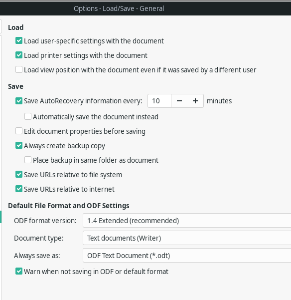

I struggle if configuration below plays a role in crashes I encounter.
