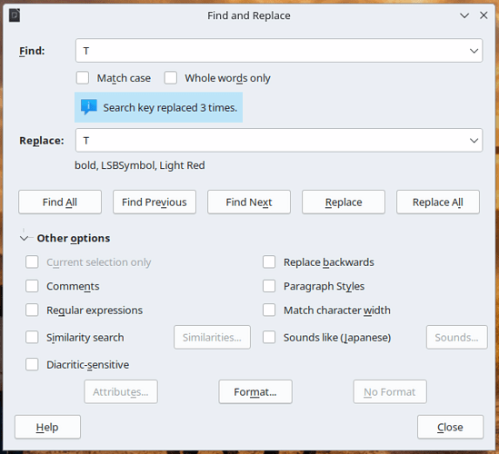

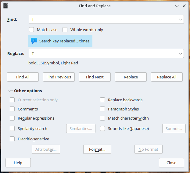

In a document I search for ’ T ’ without the quotes. I replace it with ’ T ’ and formatting: A font, Bold, Red. It does not apply the formatting and adds a page break to each line containing ’ T '. I’ve tried changing the Replace text to something else like ’ TT '. It will add the extra ‘T’ but still the formatting will not change.
  • Check the settings in the Find and Replace dialog
This is baffling me.
I’ve attached an excerpt from the full file with before and after the attached find/replace screenshot is executed.
I have discovered it is not in every document, but it does happen to me often.
This is a new issues. I perform this Find/Replace weekly and have for years.

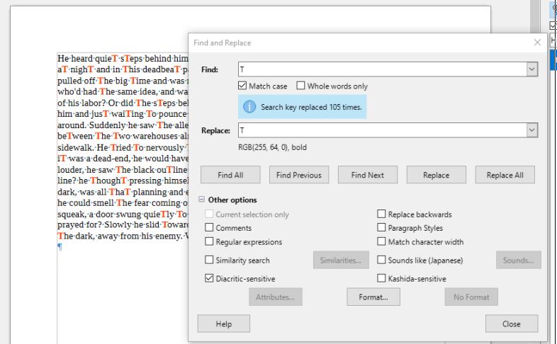

I can reproduce (LO 25.8.5.2 on Windows).
But if, instead of Replace All, I use Replace, the insert page break before is not inserted.
More: if do you select all and clear direct formatting, you can replace all without problem.
I can reproduce in Win10 and LO 26.2.3.2
  • The extract (and I imagine the original file) is full of direct formatting,
  • I can’t figure out why Find and Replace doesn’t work as it should (I think it has something to do with that direct format.)
