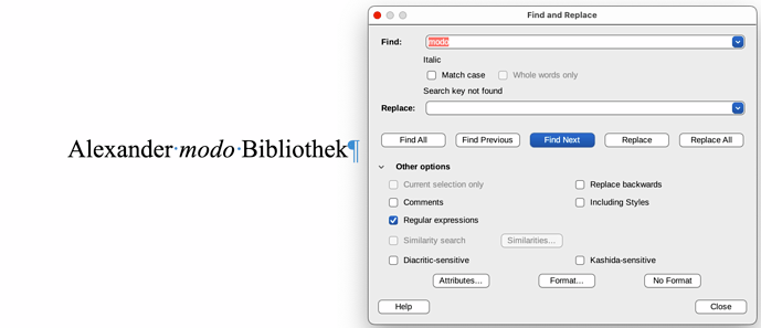

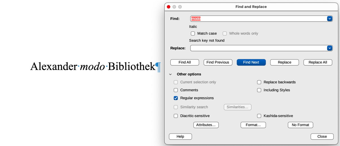

Writer: Search key not found (Regular expressions)
When I need to find something written in italics, the Search key is not found although it is clearly in the document.
I have turned Regular expressions ON since I need to find something using regex (which does not work either).
Please see the attached file. In case others confirm this issue I’ll file a bug report.
macOS 12.6.3
LO 7.4.6.2
italic.odt (14.2 KB)
Check the checkbox Including Styles
Thank you! It’s not the first time I forgot to check this.
