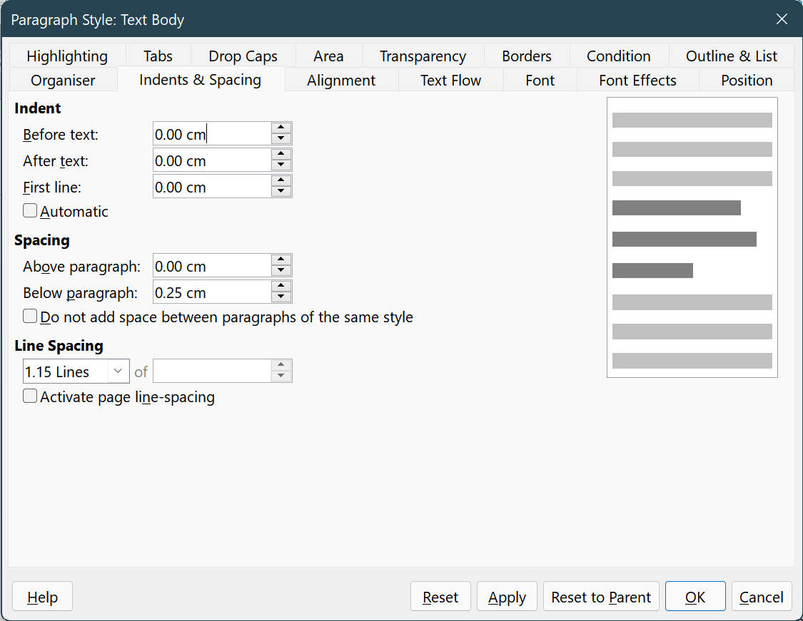

Default Paragraph Style has no extra space above and below, but Text Body or First Line Indent (and many others) have a default 0.25cm space below.

The best way is to assign appropriate paragraph styles to the paragraphs.
Select the paragraph (or the whole text) then press ( Ctrl+A ).
First delete the direct formatting with ( Ctrl+M ).
Use the “Body Text” paragraph style for text paragraphs.
Place the cursor in the paragraph and double-click the “Body Text” paragraph style.
When you change the properties of “Body Text”, the corresponding paragraph(s) will change.
