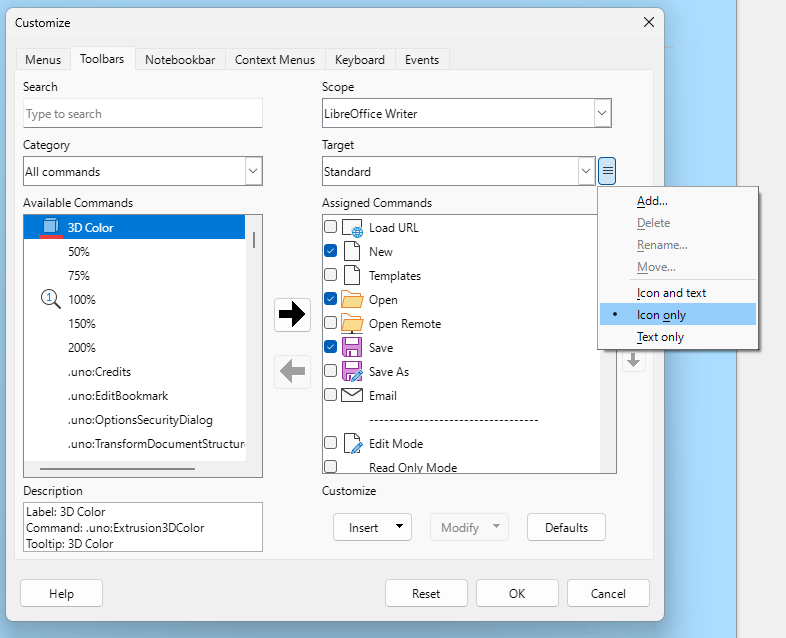

Menu Tools - Customize - Toolbars tab, and change the option to the right of the Target field to Icon only.

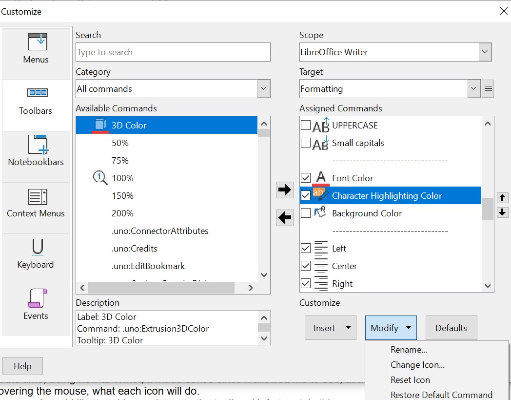

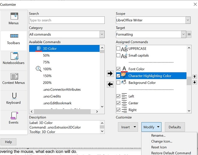

  2. I am on Writer version 26.2.4.2. When I follow the given steps I do not have the option of “Icon only”. I’ve attached a print screen of the options I have. Options are the same when I right-click on the icon or click on “Modify”
I found no option to do that for one icon at a time. So, it’s all or nothing.
Notice that your screenshot shows the Modify button options, not the menu button that appears next to the Target field.

Thank you for the answer.
You are correct. I was using “Modify” instead of the icon next to “Target”.
“Icon only” is present when using the icon next to “Target”
