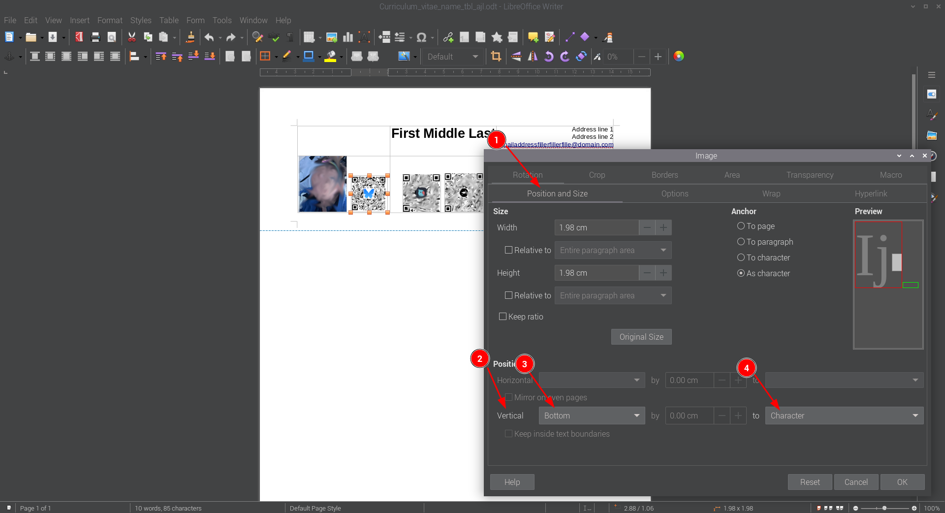

First error: Q1 would you say formatting with styles rather than direct formatting applies for image to tables or also images to whole documents?
Here’s the navigation path I used to solve as per your table styles solution.
Table
Alignment
Bottom of table row
Desktop → LibreOffice Writer 7.4.7.2 → right click blank space in cell → tap Table Properties… → tap Text Flow → Alignment → Vertical alignment → tap drop down menu → tap Bottom → tap OK.
Second error: I used keyboard arrows to move the images, which show the images still as Bottom rather than From bottom. (navigation path: Desktop → LibreOffice Writer 7.4.7.2 → right click frame/image → tap Properties… → Position and Size → Position → Vertical → Bottom → to Base line).

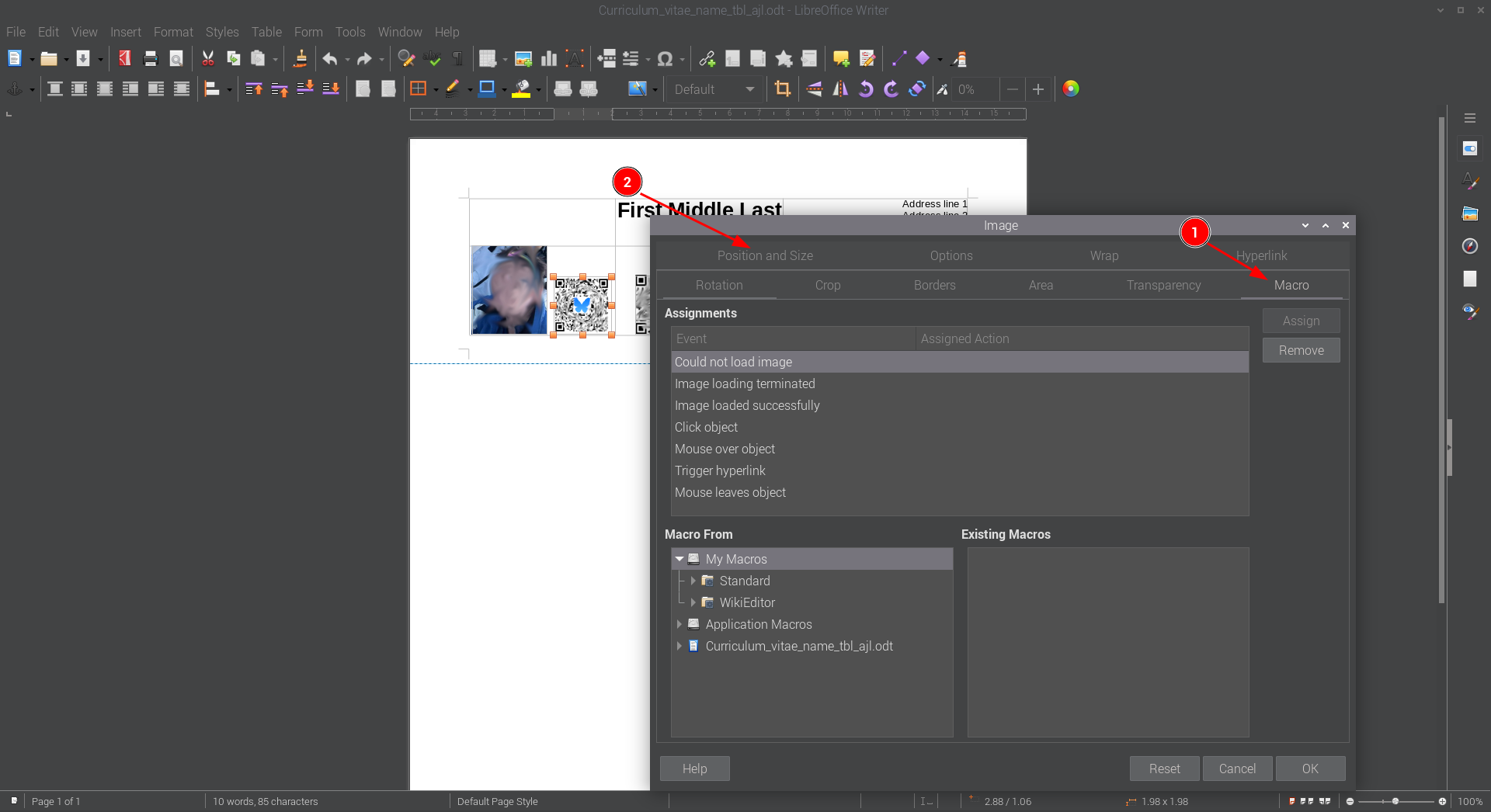

I understand the goal is Bottom to Character, as per author’s sample Curriculum_vitae_name_tbl_ajl.odt
I see Wrap tab, but I don’t see Type tab (tab seems to be named Position and Size)
I don’t understand this sentence: Then you can just click Original Size to autosize the frame.
Q2 Original here? (navigation path: Desktop → LibreOffice Writer 7.4.7.2 → right click frame/image → tap Properties… → Position and Size → Original Size)
Q3 Why would tapping Original to autosize back to original frame/image sizes be needed?
