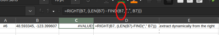

And based and these scenarios (#1-#5) I build the formula for Scenario #6.
But for some reason, I don’t know why, it is not working as I expected.
Perhaps someone smarter as I am can explain what I am doing wrong.

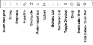

NB After you gave save your screenshot, you can drag it from your file manager onto the open editing window or you can click the 7th icon with tooltip Upload to navigate to and insert the image.
300px-202108_EN_Question_opened_for_editing_-_with_description1

wow! all that for typo :face_with_thermometer:
no real challenge then;
