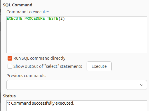

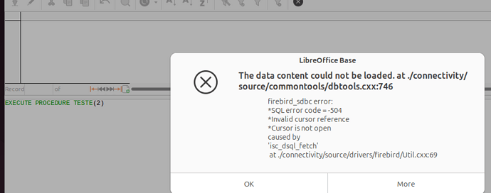

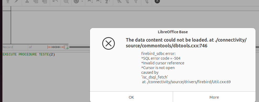

As long as I understood command is
EXECUTE PROCEDURE TESTE( < integer parameter >);
GUI does not accept this.
SQL Window execute it but in the return window message is
“0 rows updated”.
I understand a variable is needed to store the returned value.
So code, but how :thinking:

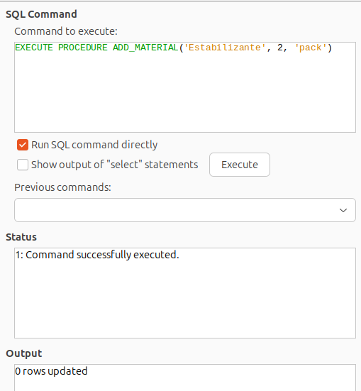

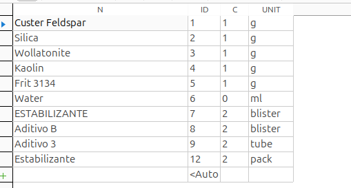

Elaborating over @Villeroy 's demo DB ask128634.odb, I’m able to execute SP to insert into MINERALS via both SQL Window and code.
But still unable to retrieve the return value that should be the new ID auto-increment :thinking:
CREATE PROCEDURE ADD_MATERIAL (NAME VARCHAR(50), COEFFICIENT INT, UNIT VARCHAR(10)
RETURNS (MATERIAL_ID INT)  AS
    BEGIN
        INSERT INTO MINERALS (N, C, UNIT)
        VALUES (:NAME, :COEFFICIENT, :UNIT)
        RETURNING ID INTO MATERIAL_ID; -- return parameter
    END
Returning without content? Might be this one: 105220 – Firebird: Insert with direct SQL - RETURNING without values
Well, I don’t know if there is no content or I don’t know how to retrieve it (?)
In code if I put
(Long) retorno = […]
it returns -1.
