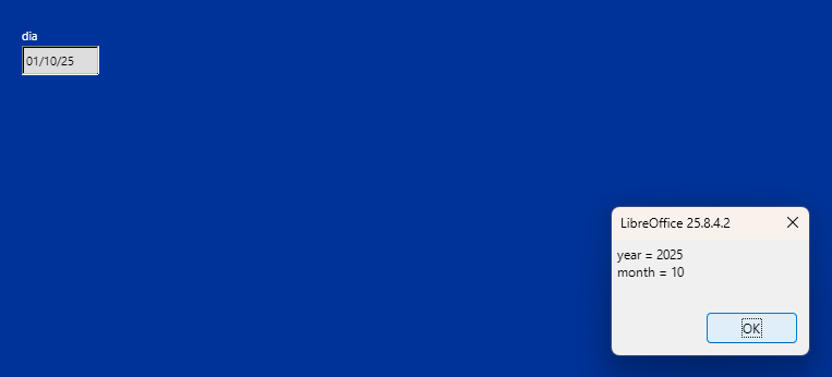

There is no date text. It is a struct as said above.
Event = click on date control.
Option Explicit
Sub ShowDate(Evt As Object)
	GlobalScope.BasicLibraries.LoadLibrary("MRILib")
	Dim Dt As Object
	On Error GoTo Erro
	Dt = Evt.Source.Model
	MRI Dt
	MsgBox "year = " & Dt.Date.Year & Chr(10) & Chr(13) & "month = " & Dt.Date.Month
	Exit Sub
	Erro: MsgBox "ERRO " & Err & Chr(10) & Chr(13) & "na linha " & Erl
End Sub

Dim Dt As Object ' declare variable to reference the date control
Dt = Evt.Source.Model ' set reference to date control

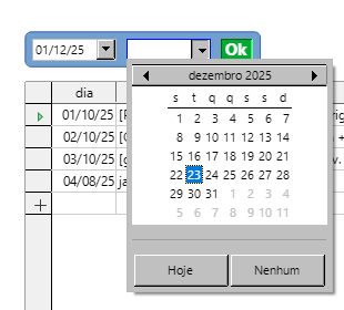

A listbox needs to be bound to some column in order to represent a foreign key:
SELECT "string", "ID" FROM "somewhere" ORDER BY "string"
An unbound listbox supports only one column.
Therefore, you need a filter table to store the filter criteria. Having a filter table, you don’t need any macros.
PowerFilter.FB.odb (72.0 KB) (2 listboxes, 2 dates, no macro)

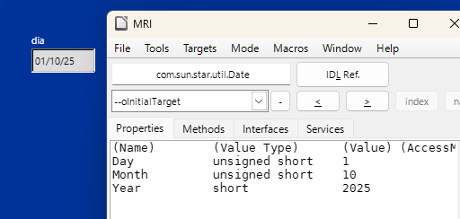

Sub Control_Event(ev)
d = ev.Source.Date 'it's a property
:+1: always learning…
	Dim d As New com.sun.star.util.Date
	d = Evt.Source.Date
	MRI d
