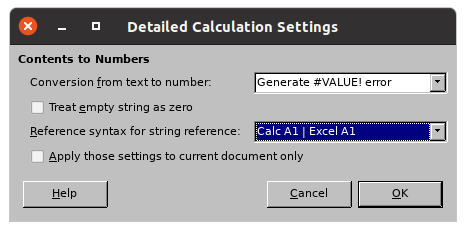

You can use in Calc the exclamation mark as a separator in the INDIRECT function and thus solve the problem with exporting to Excel format.
To do this, open your file and change the option:
Menu / Tools / Options / LibreOffice Calc / Formula / Details;
Reference syntax for string reference: CalcA1 | ExcelA1 OK OK

Your file in settings.xml has a tag:
<config:config-item config:name="SyntaxStringRef" config:type="short">7</config:config-item>
My file has tag:
<config:config-item config:name="SyntaxStringRef" config:type="short">0</config:config-item>
See also here.
The [Details…] button on the formula tab of the options dialog:
Bildschirmfoto von 2025-07-07 18-39-55
It’s complicated.
I added a link to the previous post. The main thing is that the global parameter and the tag in the file use different enumeration.
