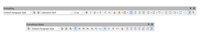

IIUC you want to add a button to the Formatting bar. The textstylebar.xml file refers to the Formatting (Styles) bar.
Try using textobjectbar.xml in your Addons.xcu.

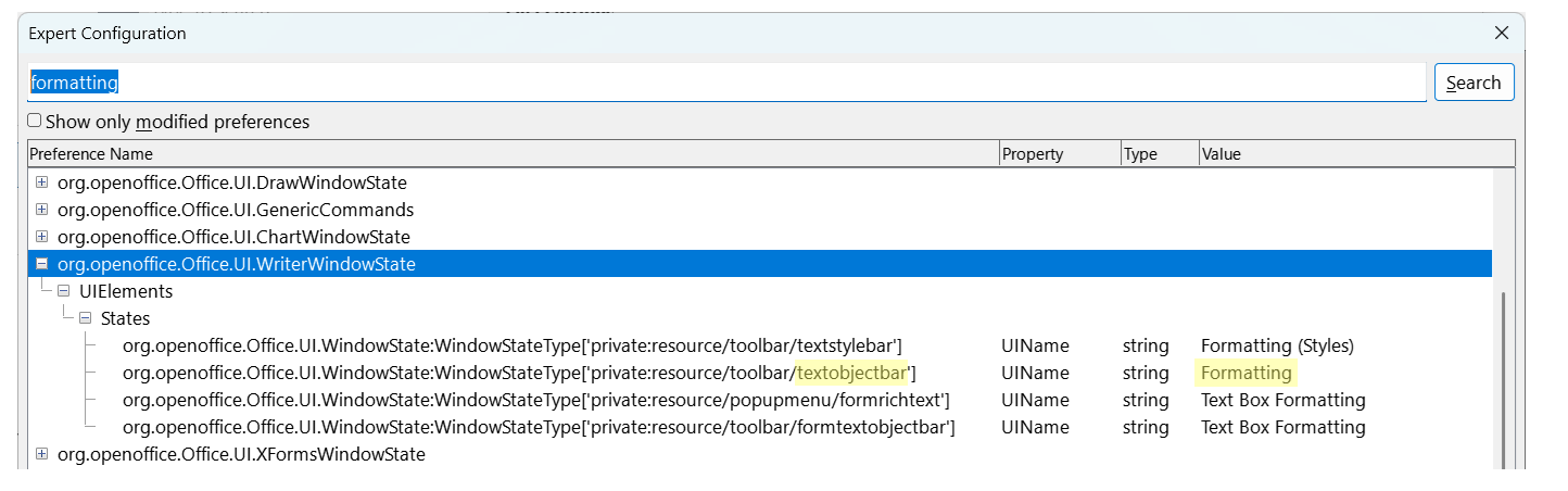

I added a button to the Formatting bar in Writer via the Tools ⟶ Customize. LibO (I am on Windows) placed an entry in my user profile under (...)\config\soffice.cfg\modules\swriter\toolbar\ i.e. the textobjectbar.xml file. Hence I assumed you should use textobjectbar in your Addons.xcu file.
Generally speaking, your question deserves an answer from someone knowledgeable — definitely not my case. I would guess one may get some information:
  • programmatically
  • in the source code (cf. file WriterWindowState.xcu)
  • via Expert Configuration (Tools ⟶ Options ⟶ LibreOffice ⟶ Advanced).
Looking for the word formatting in the Expert Configuration:
