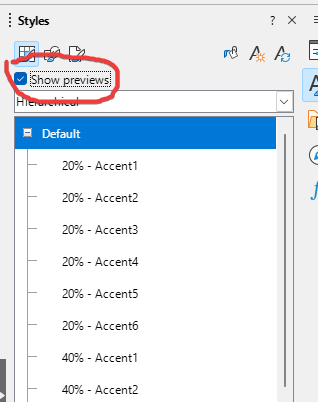

Are there NO previews of Cell Styles?
Conditional formatting will be very helpful for me, but it’s a black box with respect to Styles. See screenshot. With Show Previews checked, there are no previews. And there are dozens of Styles. How does one work with this? Is there another way I have not discovered? Thanks.

With courtesy, my issue is and was, having no way (AFAIK) to view the appearance of a style before applying it.
You got a link to a bug report about it not working.
You got a manual workaround and a more automated one. What more do you expect we can do given that we are users like yourself?
The problem I see I is that the cell styles in your screenshot don’t have meaningful names, compare them to the names listed under Status cell styles: Bad, Error, Good, Neutral, Warning.
You can CC yourself to the bug report to stay informed on progress and to register your interest in getting the bug fixed

I was blissfully or stupidly unaware of the complexities of Styles and merely wanted to do conditional formatting for visual discrimination based on cell contents.
It might make more sense of the styles if you arrange them by Hierarchical rather than All Styles.
Drop the idea.
A cell style describes 92 properties, many of them structured, some as trees.
The most relevant style properties for Calc are structured or complicated.
How should (e.g.) a preview of a specialized number format look? It can contain internal conditions defined by its format string.
What about border formats? ...
Well, a few style properties, mainly character propertes could be previewed. What use?
