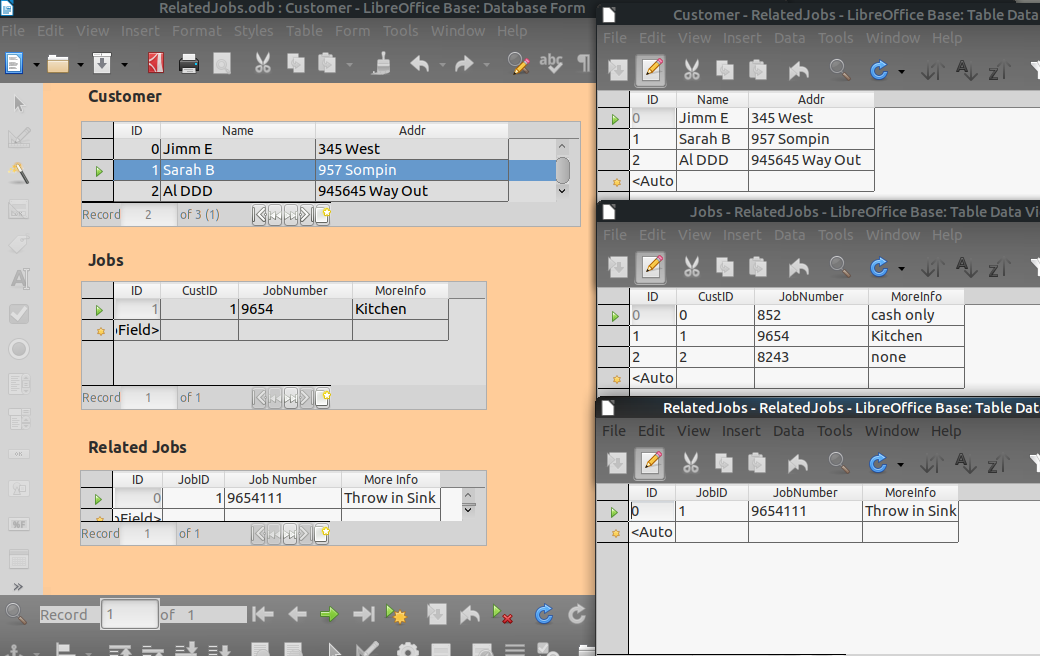

Hello,
Do not see the need for any macro or adding job numbers onto other numbers - all seems messy. Just create a third table of RelatdJobs. Basically the same information as Jobs table and links back to it. On form you would have Customer->Jobs->RelatedJobs:
Going off of Ratslingers suggestions I was able to accomplish what I needed.
No macro’s needed which is always better.
Thank you very much for your guidance.
