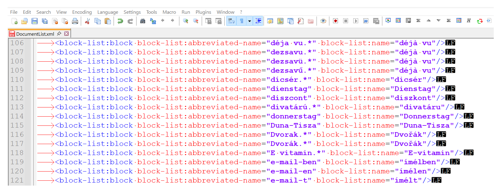

Windows 11, 64 bit
I used 7-zip to unzip the .dat file, then opened the DocumentList.xml file with Notepad++, set the “Pretty print” option (provided by the XML Tools plugin mentioned by @jfn) and added/deleted some entries. Rezipped the files (.dat extension), and voila!
