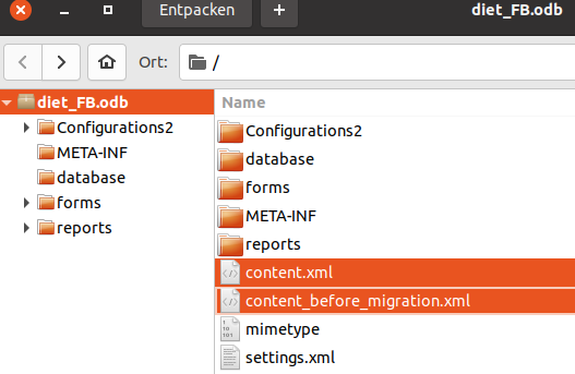

- Disable experimental features. Migration wizard is an experimental feature.
- Open the Base file in a packing tool. There will appear “content.xml” and “content_before_migration.xml”. Delete “content.xml” and rename “content_before_migration.xml” to “content.xml”. Save the file.
Now you could start the old HSQLDB again.

Your .odb is a zip file actually. Open the zip file with an appropriate program. If you don’t know which, rename the file from .odb to .zip and double-click.

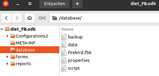

EDIT: Screenshots of a file “diet_FB.odb” (HSQL, automagically converted to FB) opened with Ubuntu’s package manager. The zip archive contains both databases in the database directory and 2 versions of content.xml.

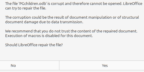

I opened the .odb as a zip, changed the content names but now I can’t open the database. I am getting a message that the file is corrupt, I did have to save as a .zip and then rename as .odb
If I click no it tells me it cannot be repaired and cannot be opened
If I click yes it opens as a blank writer doc - with the name xxx.odb (repaired document)

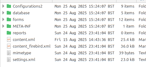

This is current (renamed) files - what is odd is that the content.xmi file is dated 15th Aug - pretty sure that I had made changes to it after that (and before it became a firebird) -although like I said I didn’t know it had migrated On the 15th I would have been checking everything was ready/updated where nec to add the new data. (most new data was added via calc, then additional data added via forms on 23rd/24th)

See the same behavior here - will have a look.
Seems it isn’t allowed to have saved content_firebird.xml inside the *.odb-file. When I delete this file the *.odb-file will be opened without any problem.
Brilliant - that now works.
