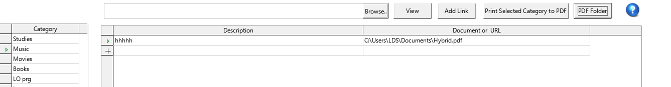

Currently I use a macro to generate a pdf from a report ( from memory an adaptation of a macro byRobert Grosskopf).
The macro is run from a button, runs an existing report, saves a pdf version to a specified folder and name, displays a message box
where the pdf is located and its name after the report is opened.
All working perfectly fine, however I would like to prevent the report from being opened, simply generate the pdf and a message to where it is.

So the question is is it possible to adjust my current macro so that it does not open the report or open and close it invisible ?
Thank you for your guidance
