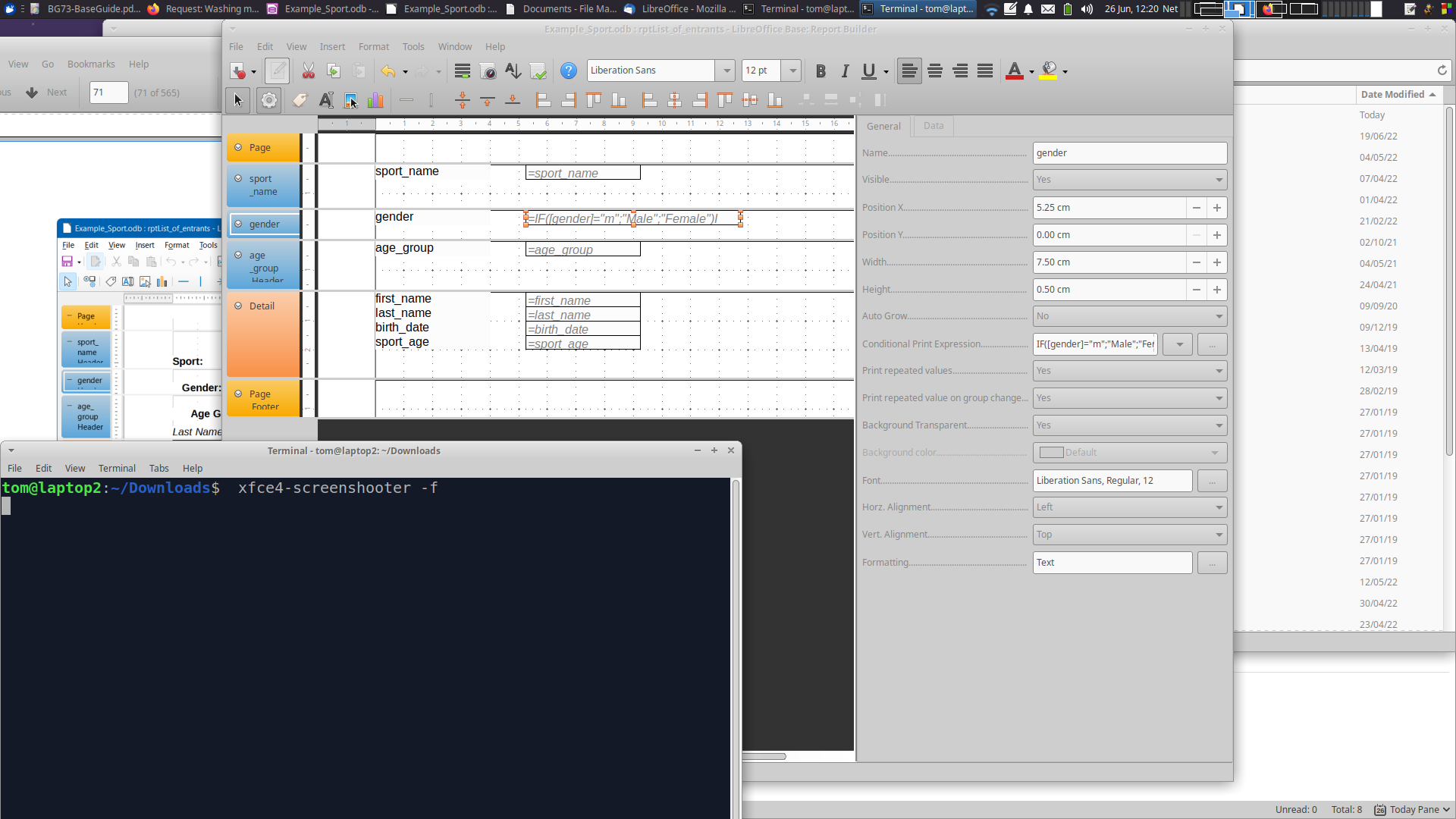

I’ve been working through the BG7.3 Base Guide and on page 69 the conditional print expression is returning nothing. Is there a way of debugging this to find out what is going wrong?
This code =IF([gender]="m";"Male";"Female") ?
Is the a field “gender” in datasource?
Could you show a screenshot of the field with this content, together with properties of the field on the right?

The query runs fine - its the Conditional Print Expression that is failing.
@madtom1999 : Have a look at the code. If it isn’t a cursor inside the field it will end with / . Feel free to upload the example database to see what is going wrong.
@Villeroy : The example should show how to get the result with ReportBuilder, not with a query. It should be an example for using formular in a report. It is the first example shown in the Base Guide, see BG 7.3, p. 69.

I compared mine to the example DB version and could find no reason for
the thing to fail, I deleted the report and have built it again and it
functions as it should. Does Base list errors somewhere?
There will be only error-messages in Base (forms, queries and tables), but nothing except when reports won’t run at all. So you will often get this behavior you described: Field is empty, no error appears, but you don’t know why …
