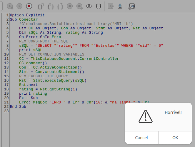

Add a screenshot of the macro editor with your macro.
To me here the connect works when running it directly from Macros GUI.
Option Explicit
Sub Conectar
	'Globalscope.BasicLibraries.LoadLibrary("MRILib")
	Dim CC As Object, Con As Object, Stmt As Object, Rst As Object
	Dim sSQL As String, rating As String
	On Error GoTo Erro
	REM CONSTRUCT THE SQL
	sSQL = "SELECT ""rating"" FROM ""Estrelas"" WHERE ""eid"" = 0"
	print sSQL
	REM SET CONNECTION VARIABLES
	CC = ThisDatabaseDocument.CurrentController
	CC.connect()
	Con = CC.ActiveConnection()
	Stmt = Con.createStatement()
	REM EXECUTE THE QUERY
	Rst = Stmt.executeQuery(sSQL)
	Rst.next
	rating = Rst.getString(1)
	print rating
	Exit Sub
	Erro: MsgBox "ERRO " & Err & Chr(10) & "na linha " & Erl
End Sub
ConFromGUI
