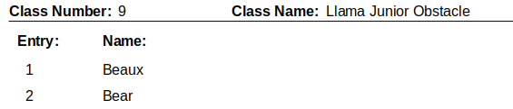

I have a weird issue with the attached database. When I run the Class Listing report, I get a blank record for the 1st line in Class 9. I can’t figure out where this is coming from. There are no blank records in the tables that drive the report. Does anyone have a suggestion of how to troubleshoot this? I expect I could remove the blank record with conditional printing. but I’m worried that their is a flaw in the database design. I want to understand what’s going on.

This is a record with request not to display. It is a bug (can report here > Bugzilla).
You are printing Entry & Animal Name on the detail line. For those items you have set them not to repeat:
Screenshot at 2022-02-25 15-39-56
Print on Group Change does not seem to do anything and that is where I see the bug. If you turn on Print repeated values, you will get:
Screenshot at 2022-02-25 15-39-23

Print repeated value on group change never worked: Bug 103387
