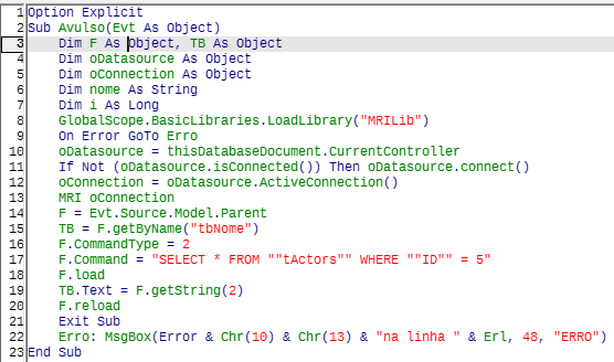

I was trying to solve it the way below, following proposed SELECT Command, and at first just 1 TextBox in the Form.
Key was your .load!
So, no need to setup an explicit connection?
Avulso
Thank you @cpb, this worked out great. I should have used the “load” command instead of “reload”.

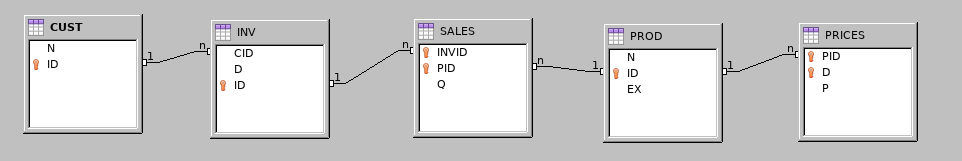

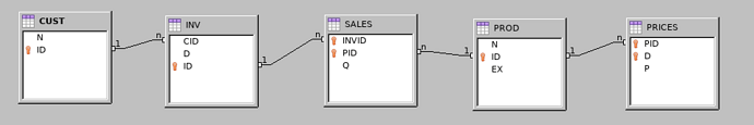

Or perhaps consider adding a 7th table with date column – analogous to the “joins” of many-to-manys – if convenient to keep record of changes in the set of properties of each material along the time (?)
Of course, if each time some “material” changes any property it receives a new ID, no sense for this. But anyway, a way to keep records of changes in the set of properties and IDs could be convenient :thinking:
Like changing prices in some invoicing application where you need comparative statistics based on prices in the past.
Invoices_Articles_Prices.odb (164.9 KB)
