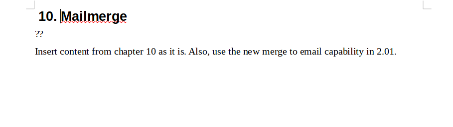

An example of a similar problem is in the AndrewMacro.odt book, section “10.7.6. Inspecting accessible content (by ms777)”.
this is the whole Chapter10…very helpfull!
I’m sorry, I’ve corrected the link.
