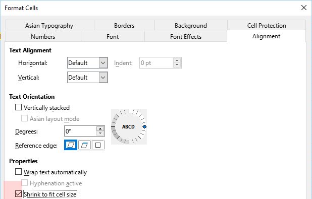

As a workaround, you can set the cell formatting to [x] Shrink to fit cell size, and change the column width in the print preview. But you will get different text sizes.
