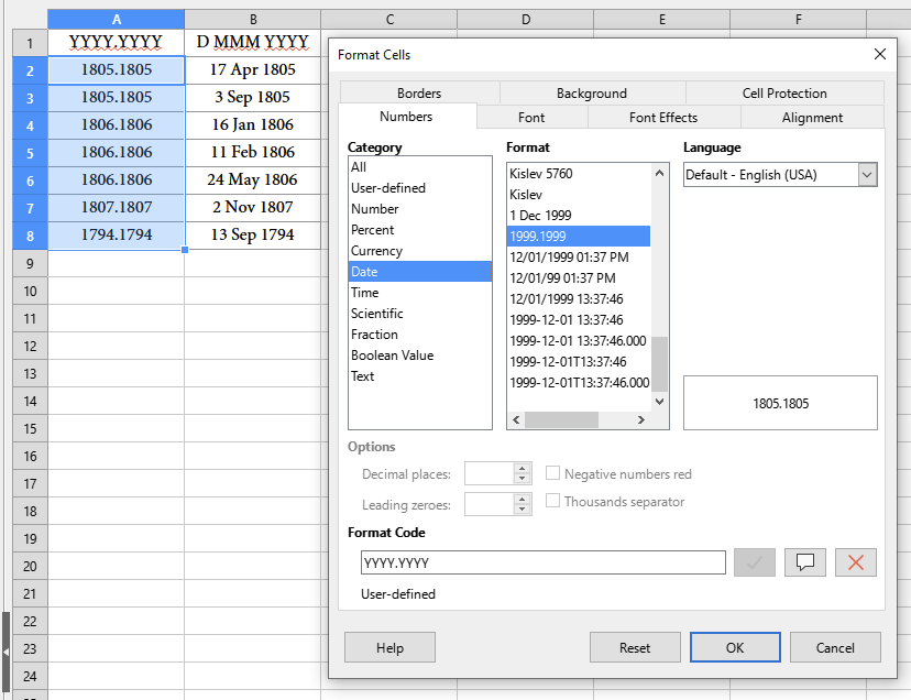

Is it possible to format dates as decimal year? Or will this require additional steps than simple formatting? For example, D MMM YYYY works very nicely for displaying the date, but YYYY.YYYY not so much:

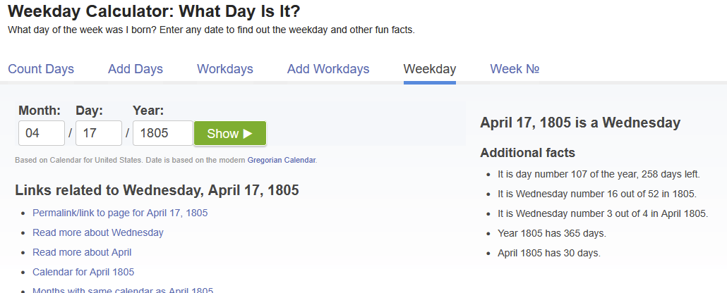

Hmm… trying this manually, and starting with https://www.timeanddate.com/date/weekday.html
1805 + (107/365) = 1805.29315068493

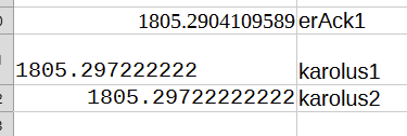

=YEAR(A1)+YEARFRAC(DATE(YEAR(A1);1;1);A1;3)
And that’s the difference. It’s the 107th day in the year, but my formula calculates it as 106th day, because otherwise 1805-12-31 would yield 1806 instead of 1805.99726027397
Fwiw, I do not see any difference between my formula and karolus’ second formula or third, all yield 1805.2904109589 for 1805-04-17.
