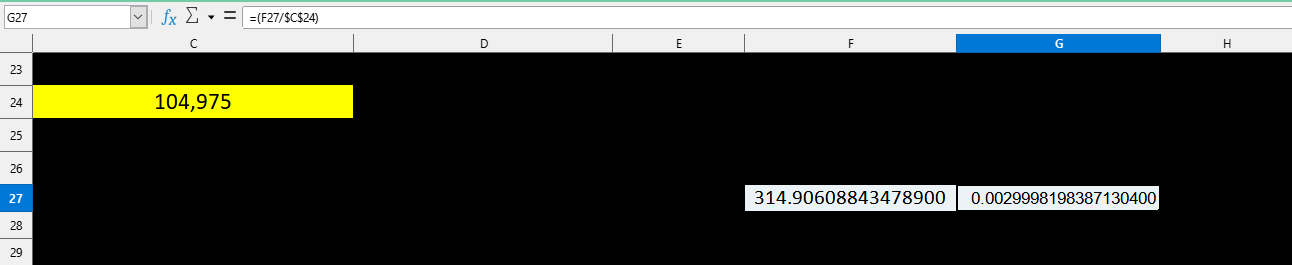

Here is the screenshot:
I have the formula cell highlighted.(edit: the formula cell is to the far right … it’s been a long day)
In the formula bar, the formula can be seen (Click on the image to expand it).
Thoughts anyone?

… and if you alter the format for C24 to display 4+ decimals?
All that will do is auto-round the display of the number … it won’t change the number, it will only change the display to a rounded up version.
The only way to see the number, is to add decimal places until zeros appear.
That way, you can see the number that the spreadsheet sees.
Oh hang on… FFS !!!
I just realised that you were talking about 104,975.
You are not gonna believe this, because I had expanded the decimals previously, but amazingly NOT ENOUGH!
Get this:
104,975.00028864600
What are the damned chances of that?
