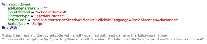

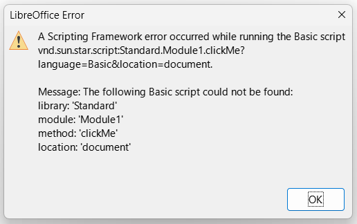

Problem which I’m dealing with is that when I am trying to register an event, it looks for the routine in the form document, instead of my database file where my code is. If I change the URI “location” parameter from “document” to “application” and place my routine in “My Macros & Dialogs” then everything works fine. Thus, the question that I am dealing with is if at registration of an event the URI of:
vnd.sun.star.script:LibName.ModName.FileName?language=Basic&location=document
can be changed to be pointing back to my database file library.modules?

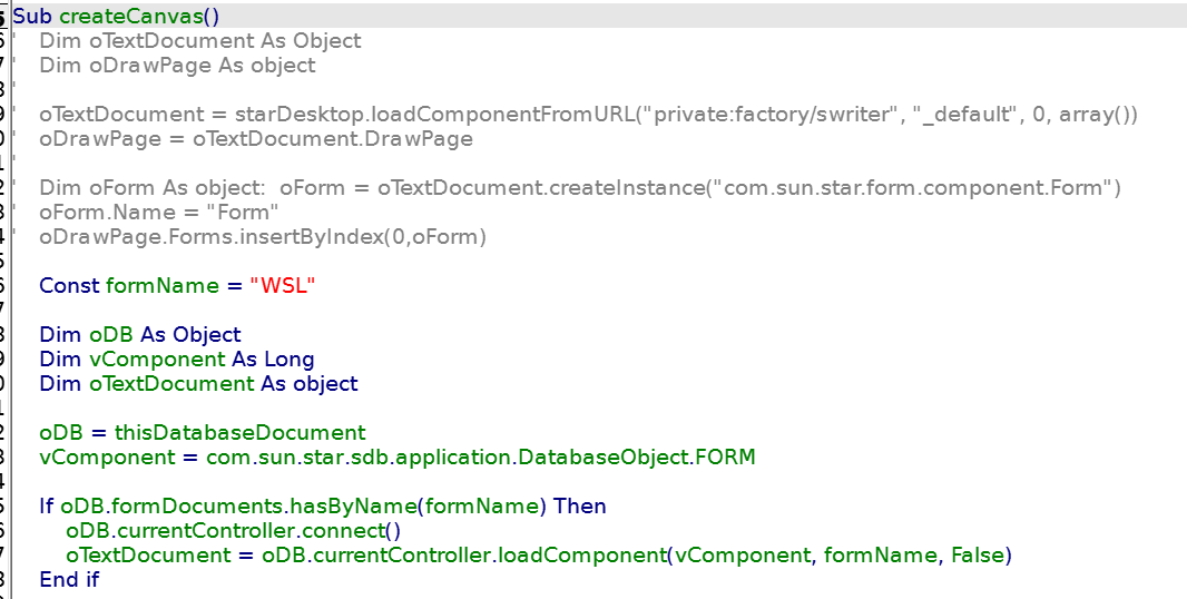

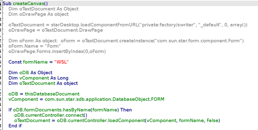

event routine calling issue.odb (4.7 KB)
. The problem can be recreated by running “createCanvas” routine, and then clicking the button which appears
There event is bound to a button which is programmatically created into a new writer document, from a database file code. I am under the impression that the event is looking for the routine everywhere within the writer document framework.
The workaround which gave me positive results was creating an empty form, in advance, and utilizing it. Which leads me to believe that if there is no way of altering the URI to include the fully qualified path before the library.module.routine then the former is the only solution I have. Otherwise, maybe putting the code into a writer/calc file instead and then connecting to my database without using Base file would be a more viable approach?
I’m getting the following error message:
