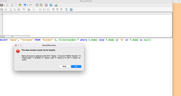

Here is the test on my end:
Beginning with “k” all double quotes are lost. Also “Filterkunden” instead of “FilterKunden” in the example database. But main problem seem to be nuill instead of null at the end of the code.
FilterKunden.odb (12.6 KB)
Thank you for your patience. With all the trees around I don’t even see the wood. :slight_smile:
Syntactically it is clean now. However, if I enter a partial name (e.g. ‘Sp’ instead of ‘Specht’) I don’t get a result. If I enter the full name that one customer entry is shown.
