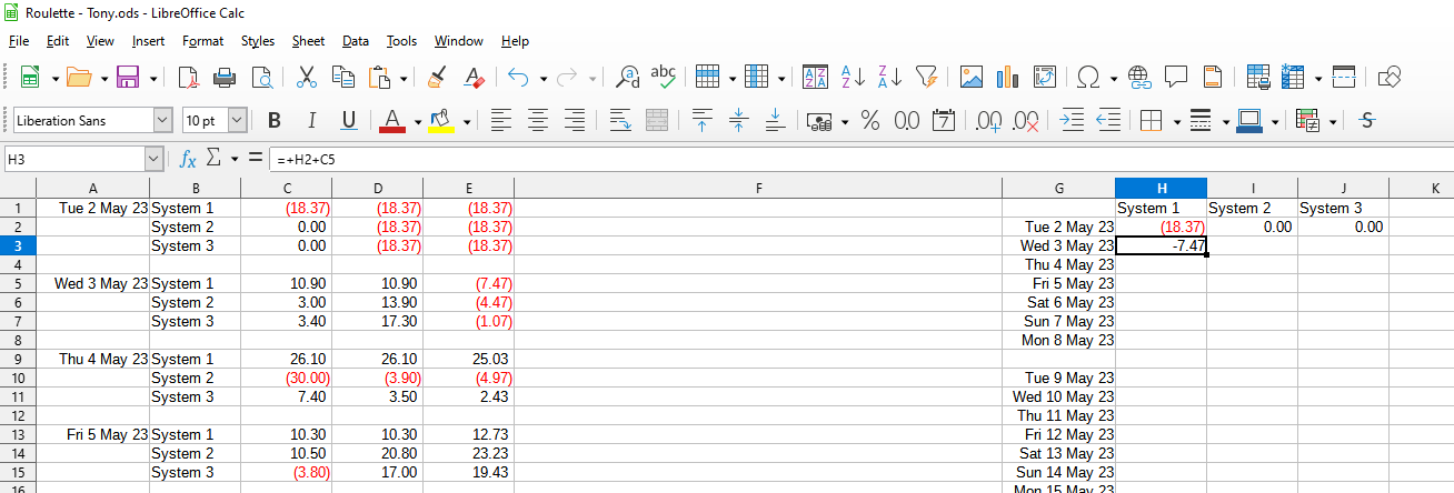

Is there a way to make a formula reference a cell at set points.
I am trying to use a formula like =+H2+(C1+4). Where the C1+4 becomes C5. Subsequent H cells would then be C5+4=C9 etc

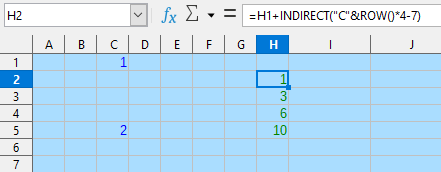

Excellent. Thanks for that
=H1+INDIRECT("C"&ROW()*4-7)
