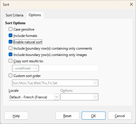

Before modifying data (which may be done using Find & Replace with regular expressions, and even without them just by replacing “m” with nothing in a given column - just make sure to format the column as numbers prior to the replacement), check if using DataSort dialog, and checking “Enable natural sort” checkbox on Options tab, could resolve it. This may be better in case, when you actually don’t intend to do calculations on these cells, just sort by them.

The natural sort solved it, thanks very much, you just saved my afternoon!
