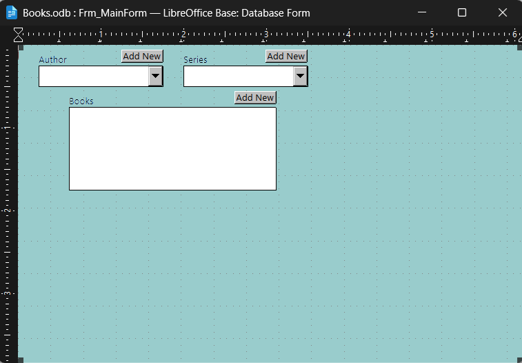

I"m not sure if I’m using the correct terminology, so I’ve added an Image below to point it out (Yellow and Blue Arrow)
Is there a way to change/remove the Exit,Max,Min buttons, along with the Title, in the windows title bar?
Thanks.

Well, I got it in there and cohesive. When I try to edit the form to set the “When Loading”, this is what it looks like hahaha (going to go REM the other code to see if that changes this as I can’t access anything at the moment) Oh, just FYI, when I just run the form, it runs like it’s supposed too (buttons still there tho). Still working on trying to get it in “When Loading”

That let me into the regular Edit screen, but now there is no “When Loading” option in the list for Macros.

OK, I’ve removed any call to the hideFormMenu. New module created, and set to “When Loading” event in Form Properties. I don’t see any difference when running or editing the form.
I’ll bet it did take a while, that’s a hefty bit of code.
I tried adding the HideFormMenu back, just to see. It still looks like the last image I sent lol
Updated previous post! Are any errors? That Module2 probably needs to be created in the “My Macros & Dialogs” / Standard library in the left navigation pane of the basic editor window. Afterwards, reassign the macro in the Form - Form Properties - Events - When loading - as its address will have changed. Let me see if I can come up with a working sample of my form with macros. Then you should be able to model your own from it.
