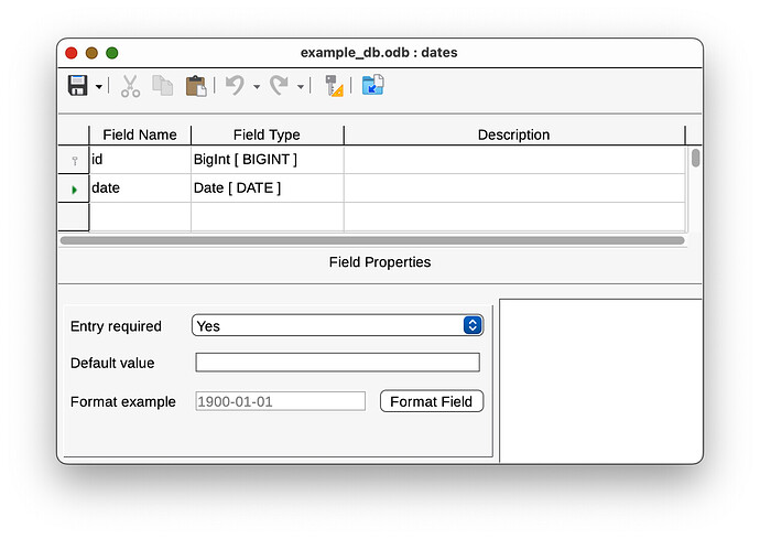

First I created a new database named “example_db.odb” with a single table named “dates”. The table has two columns, id and date as shown in Image 1 below. I set the Field Format of the date column to YYY-MM-DD.
[Image 1 would go here]
