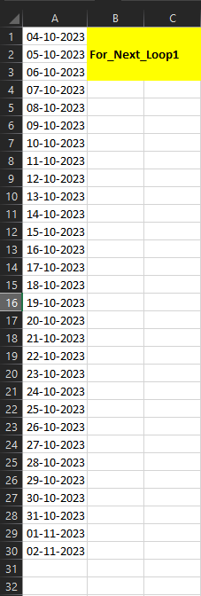

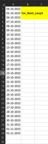

For Next Loop1
Sub For_Next_Loop1()
      Dim i As Long
      Dim dt As Date
      dt = "3/10/2023"    ' yesterDay's Date
      For i = 1 To 30
            Range("A" & i).Value = dt + i
      Next i
End Sub
Result

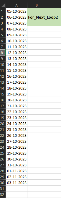

For Next Loop2
Sub For_Next_Loop2()
      Dim i As Long
      For i = 1 To 30
            Range("A" & i).Value = Date + i
      Next i
End Sub
Result

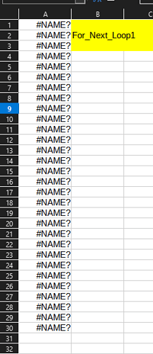

For Next Loop1
Dim Doc As Object, Sheets As Object, Sheet As Object
Sub For_Next_Loop1
	  Dim i As Long
	  Dim dt As Date
	  Doc = ThisComponent : Sheets = Doc.Sheets(0)
	  dt = ("3/10/2023")    ' yesterDay's Date
	  For i = 1 To 30
	  		Sheets.getCellRangeByName("A" & i).Formula = "= dt + i"
	  Next i
End Sub
Result

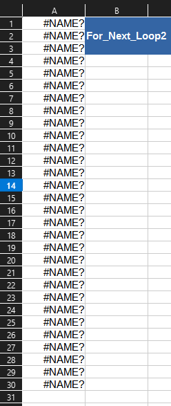

For Next Loop2
Sub For_Next_Loop2
	  Dim i As Long
	  Doc = ThisComponent : Sheets = Doc.Sheets(1)
	  For i = 1 To 30
	  		Sheets.getCellRangeByName("A" & i).Formula =  "=Date + i"   ' Cell A1 To A30
	  Next i
End Sub
Result

The Formula property is used to insert a formula into the cell, you must insert a value so you must use value, as regards the starting date you must use a function to convert the text into a valid date
See Link
DateValue
Hi, @gaetanopr Thanks For the replay and Correcting my mistake and Both Codes Now work and got results
