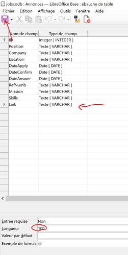

I can share with you some screenshots.
Maybe you could suggest me something from screenshots:
Upon opening .odt file it looks like this. I select table Annonces, then click on Edit
… will be continued
Then I change max length in the field link (150 instead of 100), then save it
After closing .odt and reopening it I see that length of link is still 100
You are using Firebid, not internal HSQLDB. But it woks here without any problems through GUI.

A general hint: You may reduce the size of the window to have less white space in the middle, and you should always include the bottom status-bar. In this thread, Robert could have skipped all hints to HSQLDB if he could read Firebird at the bottom.
