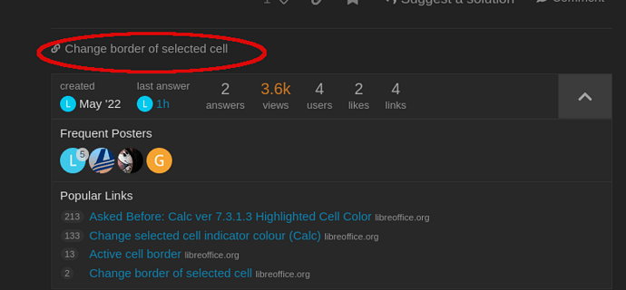

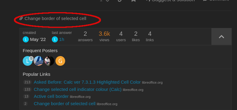

to be more precise about somewhere
discourse keeps track of that in the summary below the OP :
