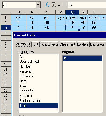

Change Category to Number.
Yes I notice will perform that action before data entry.
However if I edit the next cell below (Q4), THEN try to change the category to number, it fails. (It will still show the equal sign before the number.)
However, if I delete the data in the cell, change the category to number, then it will work. But not the other way around.
After more experimentation, a thing that works after data entry is the “format as number” icon on the tool bar. But if I use the pull down menu, it fails.
I am wondering if there is a setting in my config that when creating new sheets that defaults all cells to text?
Changing the category will not change the cell content until you edit/change the cell content. You can try with menu Data - Text to Columns.
No. Just create a new Sheet and type any number.
With Ctrl+F8 you would see different content type in different colors: numbers in blue, and text in black.
By the way, to enter numbers, there is no need to add before an equal sign (=).
In the status bar, there is a hint if the cell content is number or not:
imagen
