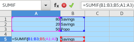

=SUMIF(B1:B3;B5;A1:A3)
Screenshot from 2022-04-25 20-07-52
LibreOffice help on SUMIF function.

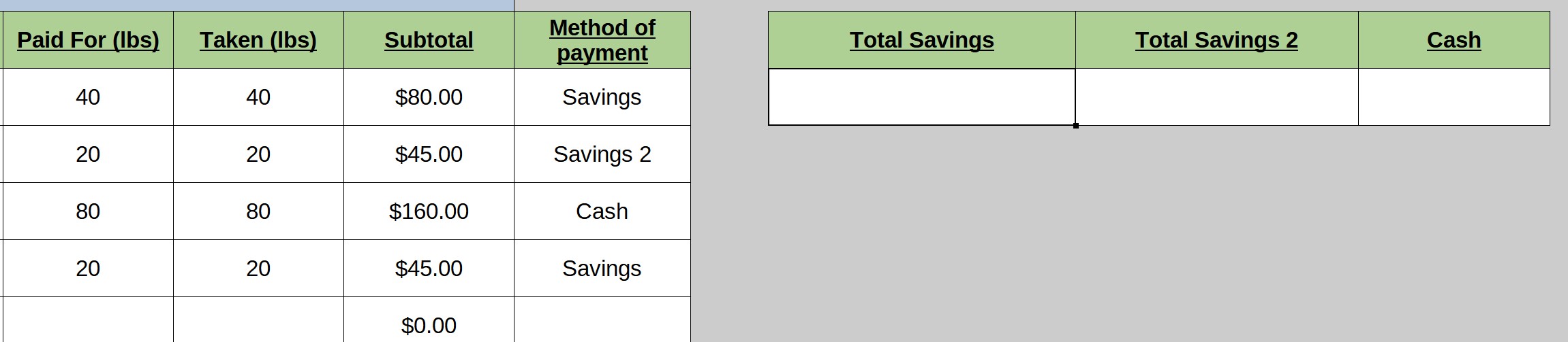

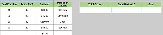

I tried what you suggested, I can’t seem to make it work. Here’s a screenshot of what I’m looking at
@Prelude, thanks for visiting. Screenshots are pretty minimal info. Can you go ahead and upload your sample using the up arrow icon?
From what I see, I’m not sure you have the idea of the $B$5 in LeroyG’s example. That is what you are comparing to, the type of account. You could put Popo in there, and your sum would be 50. Check out $E5 in the example ODS attached regarding the E5 vs $E$5 vs $E5.
SimpleSUMIF.ods (16.2 KB)
This worked! Thanks for your example, that helped me understand what he was saying. Thanks a lot!
