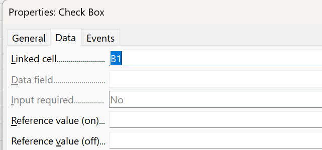

I managed to find how to put the checkbox into calc, however I was wondering if there’s a way to have it deduct from a number/cell if checked.
I’d like it so, as seen in the picture, in the “leftover box” it has my income amount and when the checkbox is checked it takes that amount from the leftover number. (to mark it as paid)

You can link it to a cell, that changes cell value, between true and false, 1 and 0. What you can use to make a conditional sum, with SUMIFS function.
