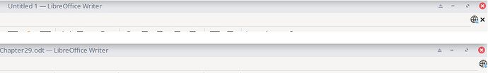

I am editing a book with multiple chapters in seperate files and I’ve noticed recently that when I first open Writer and then open a file, I can edit it and then close it with the Close Document ‘X’ on the right side under the Minimize, Maximize and Close program buttons. However if I then open another document from the Libre Office Startup window, the Close Document button is no longer there. This happens every time I perform this set of actions and while it’s not interrupting my work flow, it is annoying.

Here is an image showing what I see:
I’m not sure if this is a bug, feature or just wackiness with my computer. I’m looking to see if there is a fix or explanation before I submit a bug report.

Understood, however I am only editing one file at a time and the Close Document X (not the larger Close Program X) is not there after I close the first document and then open the next one. That is the behavior I am asking about. I apologize if this was unclear from the originall post.
There is no another window with a document open in Calc, Draw, Impress, etc.?
LeroyG, that is correct. I open my first file in Writer, edit that file, use the Close Document X to close that file, open the next file from the LibreOffice main window and the Close Document X is not there.
Test in Safe Mode, to discard that there is a corruption in the user profile.
Anyway, you can use Ctrl+W to close a document (and the Start Center, if no document is open).
I tested opending and closing documents in safe mode. The same behavior happens. On a whim, I turned off the automatic checking for updates because the icon was next to the Close Document X. Surprisingly this seems to have solved the problem. Is it possible that the icon for Updates ends up covering the Close Document X?
