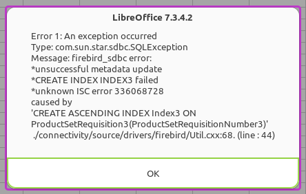

But when I used code on table ProductSetRequisition3, I got an error message:
Screenshot from 2022-07-24 00-25-44
What is wrong with code ?

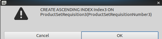

Hello @lonk,
I guessed your problem from the start but wanted to test to be safe.
Here is the print of what you create in the macro:
Screenshot at 2022-07-23 11-12-53
Now taking this and running in menu Tools->SQL... you will get an error. The reason is that table and field do not exist. What you have is converted to upper case. If you wish to use mixed case, as that is how the table is created, you must surround with quotes.

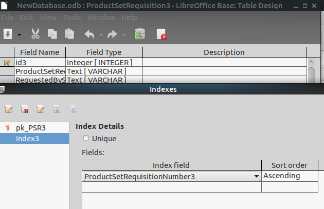

Modifying this portion of your code:
	If 		UCase(Mid(pAscendingOrDescending, 1, 1)) = "A" Then
			sSQL = "CREATE ASCENDING INDEX """
	ElseIf 	UCase(Mid(pAscendingOrDescending, 1, 1)) = "D" Then
			sSQL = "CREATE DESCENDING INDEX """
	EndIf
	sSQL = 	sSQL & sIndexName & """ " & _
			"ON" & " """	& pTableName & """"& _
			"(""" 		& pFieldName & _
the macro ran with a result in Base of:
Screenshot at 2022-07-23 11-45-58
