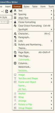

I am using Windows 11 (64-bit) with LibreOffice Version 25.8.2.2 (x86_64). I reinstalled LibreOffice and ran into the following problems:
First, the various drop down menus have some words in bright green instead of black (see the attached). Not all are as bad as the attached example but it happens in at least one case in all of them.
Second, I am unable to change the background color or highlight a given cell, line or column on a spreadsheet. I am able to highlight individual words, sentences and paragraphs in Writer.
Third, all icons on the toolbars are exclusively in black and white, other than the small color bars under Font Color and Character Highlighting when choosing a color other than Automatic or No Fill.
Any help is greatly appreciated.
Jim Jurnak
Click Tools - Options - LibreOffice - Accessibility and disable High contrast
Thank you, that seemed to work
