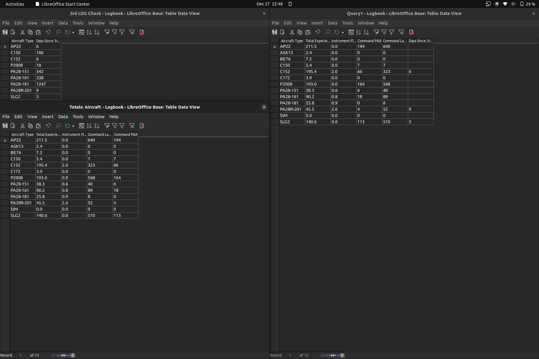

This database is a pilot’s logbook that I’ve been putting together over time, mostly from scratch, with a few lines of code copied from various online sources whenever I get stuck. Most electronic logbooks are spreadsheets and lack a lot of the analytical functions and queries I have made (mostly because, as we all know, spreadsheets perform poorly when there’s a lot of data to work with). Taking your code and adapting it to my query, I have the following code:

I’ve marked the problematic areas with comments (hopefully the formatting here works). Below, I’ve attached a screenshot of the outputs given by the current two queries on the left, and the output of the query using the code above on the right:
The code above outputs only three rows in the last column. If I compare them to the old queries, the numbers are correct, but for some reason, the rest of the numbers from the top old query did not end up in the new query. Below is the actual code for the old query:

Pretty much exactly what was shown in the first post, just with some of the column names changed.
So as it stands, your code is definitely a step in the right direction. Just a bit stumped on why it only works for some of the rows and not others. If you still need me to upload the database file, let me know, and I’ll work on it in the next couple of days, time permitting.

I have to admit defeat.
the clause where "Event Count" >= 3 is a road block which makes it impossible to simplify the code.
I cannot better your own efforts.
the best I can manage is to left join your very own code, sorry.
my original code will have failed because "Cat3Events" was never equal to 3 therefore the field “Days Since 3rd Last Event” returned null.

No worries. My current queries still work, so no issues there. I’ll continue researching to see if I can get the new one to work. Thanks for trying
