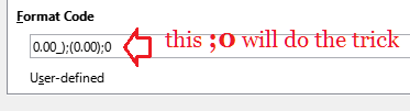

Thanks. I got 0.00_);(0.00);0 to work using Format → Cells… → Numbers tab
Better yet, I used 0.00_);(0.00);"" so that the cell appears empty, which is what I really wanted.
FWIW, I could not get it work via Format → Conditional Formatting → New Style
Better yet, a single semicolon does the same thing as two quotation marks.
But 0.00_);(0.00);; will also hide cells that look like numbers but are actually text—sometimes this trick can help you spot errors in your data or formulas.

The number format code is itself conditional formatting, so once you enlightened me of the 4 section syntax, I didn’t see a reason to persevere on conditional formatting of conditional formatting.
