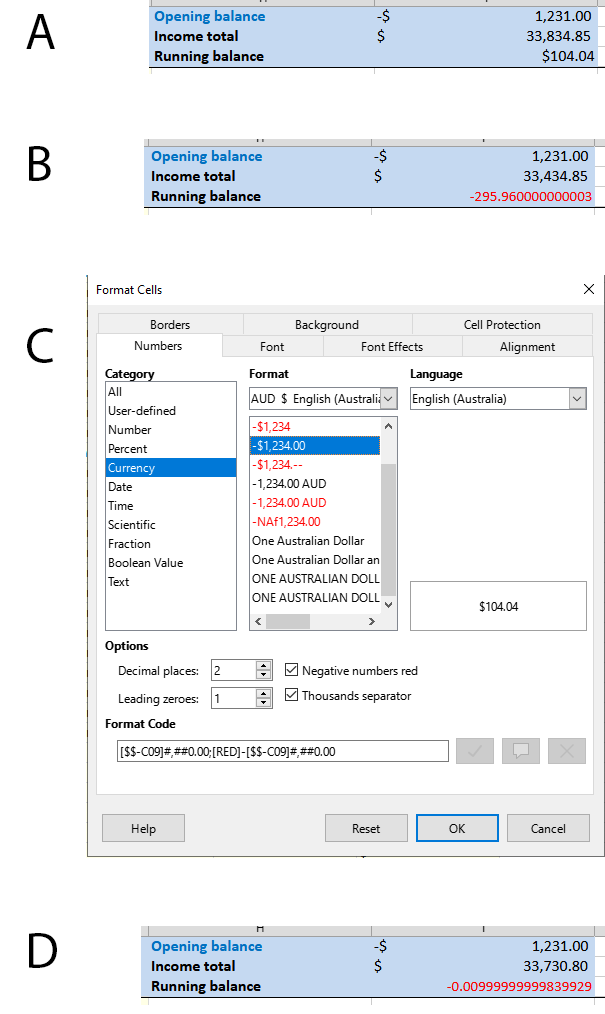

However, in Calc, when the total in the fields is positive, the formatting is as expected, eg as in A
But, as soon as the field goes negative, only the red conditional formatting works, the original field formatting breaks (the dollar sign and 2 decimal point requirements go awol) and you get a weird result like B:
The formatting on that cell is set as in C:
Is this a known bug? I can simply toggle the correct and incorrect behaviour by simply forcing the cell to switch between positive and negative numbers.
Also, if you force the cell to exactly zero, the formatting works, but if you force it to -1, you get D:
All very odd, and looks like a calculation bug to me.

Note that in Calc, conditional formatting applies a cell style, which is a complete set of formatting options in itself. Meaning: applying a conditional formatting, the applied style will replace everything, not only color - it will include e.g. number of decimals.

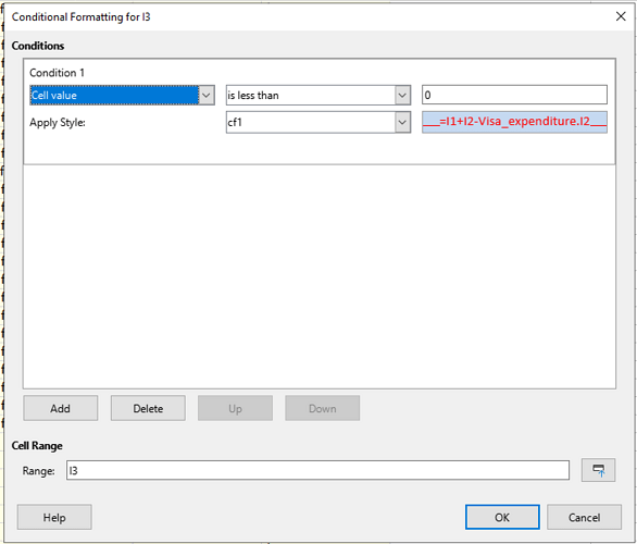

Below is the conditional formatting for the cell, as you can see, it is simple, it’s not clear how it can affect the number of decimal places of the actual cell formatting, the two things are independent in excel, so would expect them to be here as well?

And I would like to ask for details of the cf1 style - perhaps the reason for the error is hidden there in the Numbers section?
Ok, it was an issue with the style, I didn’t realise that it wouldn’t understand the style from excel, I haven’t had to edit them before. Once I set it correctly, all was fine. Not sure why it was displaying the long strings of numbers after the decimal point, maybe excel is smart enough to automatically round all numbers to the cell format settings, not sure, I’ve just never come across this issue until I used Calc.

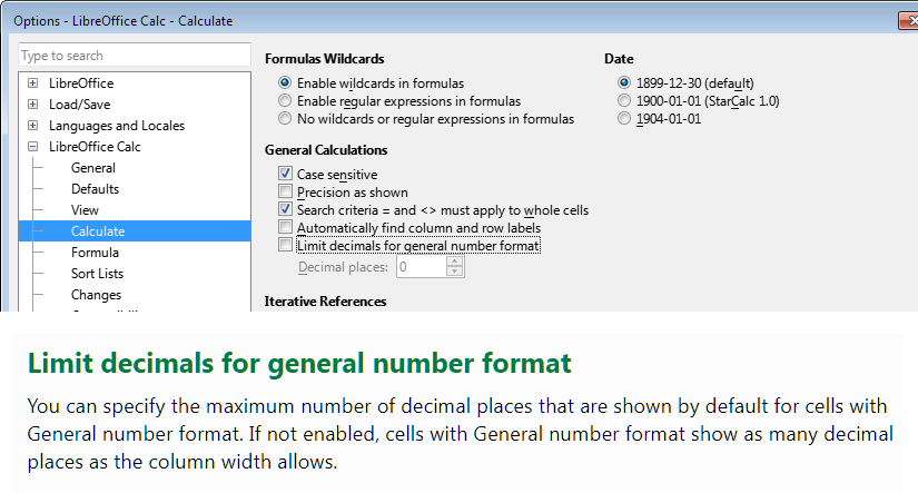

Take my word for it - Calc is not dumber than Excel, it is more polite. Instead of forcibly cutting off numbers that it considers unnecessary, it offers the user to choose whether to cut off anything in the calculation results.
Then you might even consider “precision as shown” from the Screenshot shown by @JohnSUN

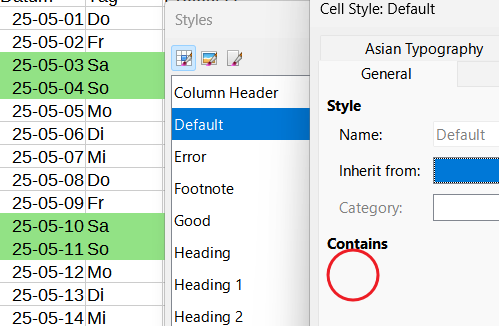

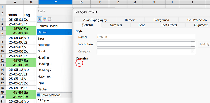

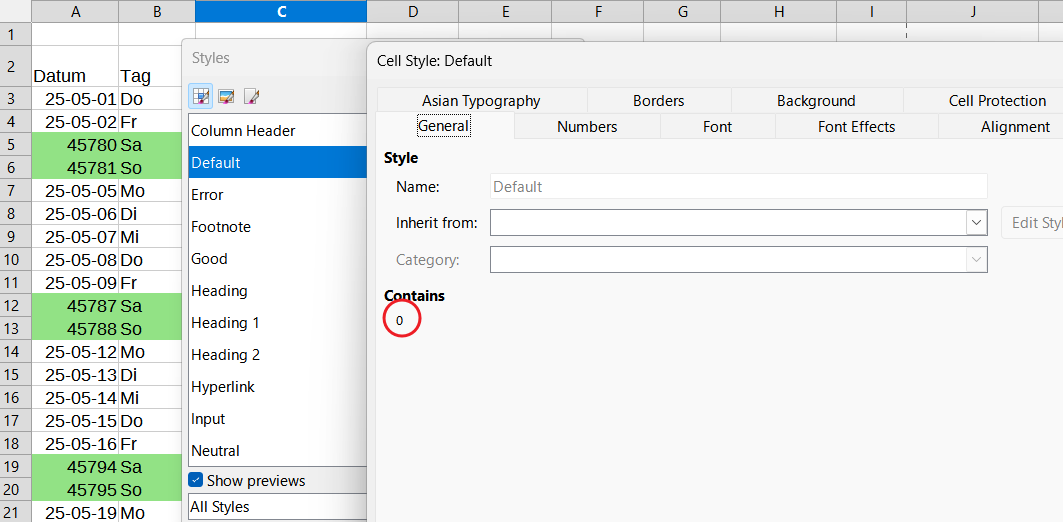

The screenshot shows a conditional formatting created in Excel and opened with Calc.
In this, the date format of the weekends is destroyed by a number format in the Default cell template.
This could also be the reason for this problem!
If you remove the number format, everything is fine again.
