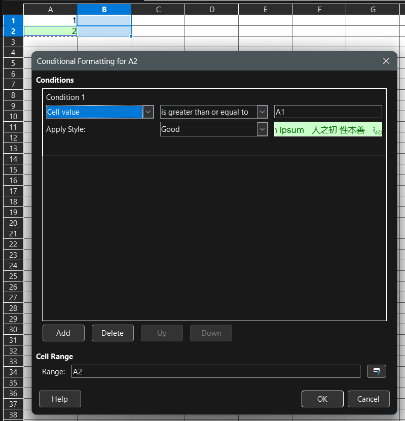

I create the conditional formatting below
I would now copy and paste the 2 cells A1:2 to the next col B and have the below result in red
basically I’d keep the condition, but applied to B2:1
I also removed the $ to unblock the references to the cells but it doesn’t work
Can anyone help?
Thanks
Teo

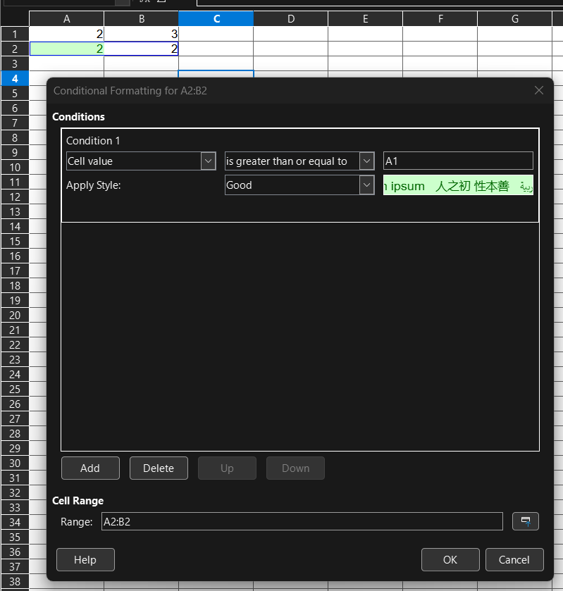

Thanks fro your txt but I don’t want a range as result of the copy but just move to col B same as done for A, please see below

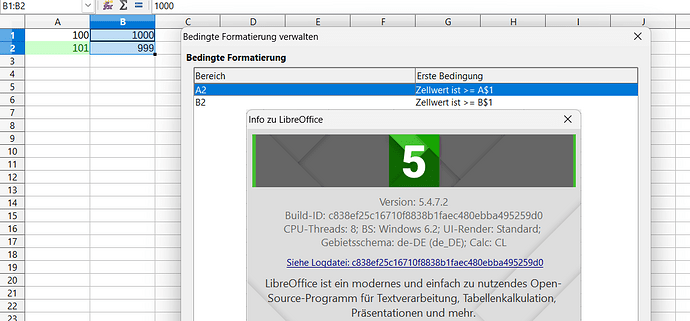

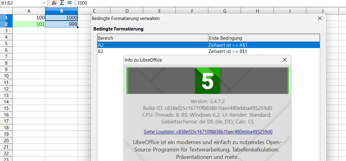

Then you have to switch to version 5.4.7. This was possible up to this version, but not after that.

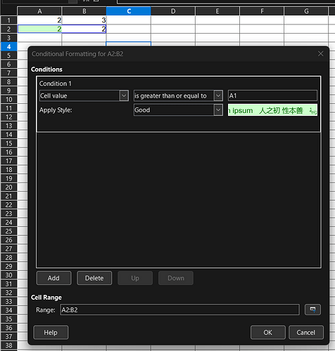

Can you share it? Maybe the actual behavior for the cell range is not the wrong one.
Thanks Leroy you’re right copying it on a new sheet it works, but I wanted it on the same sheet.

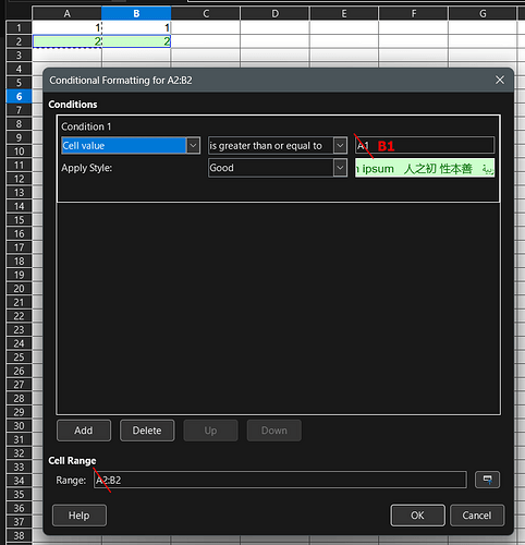

After your message I tried it and it works correctly, which means B2 refer to B1 actually and not to A1, as I wanted, which means the copied part if B2<B1 gives white normal format, while if B2>=B1 gives green cell, try it.
Even if it remains a wrong connection in the cond. format. window, which show the condition on B2 given by A1, but this is not true as I said above
in a few words when I copy and paste I wanted the condition be copied and pasted too, updated to the new cells as it happens for the formulas when you copy and paste.
As you see in the cond. form. manager after simply copy and paste in the ‘Range’ field it appears the group A2:B2 which it should be only B2 and in the ‘Condition 1’ field it remains A1 which should be instead B1

that’s the file
cond form.ods (9.1 KB)

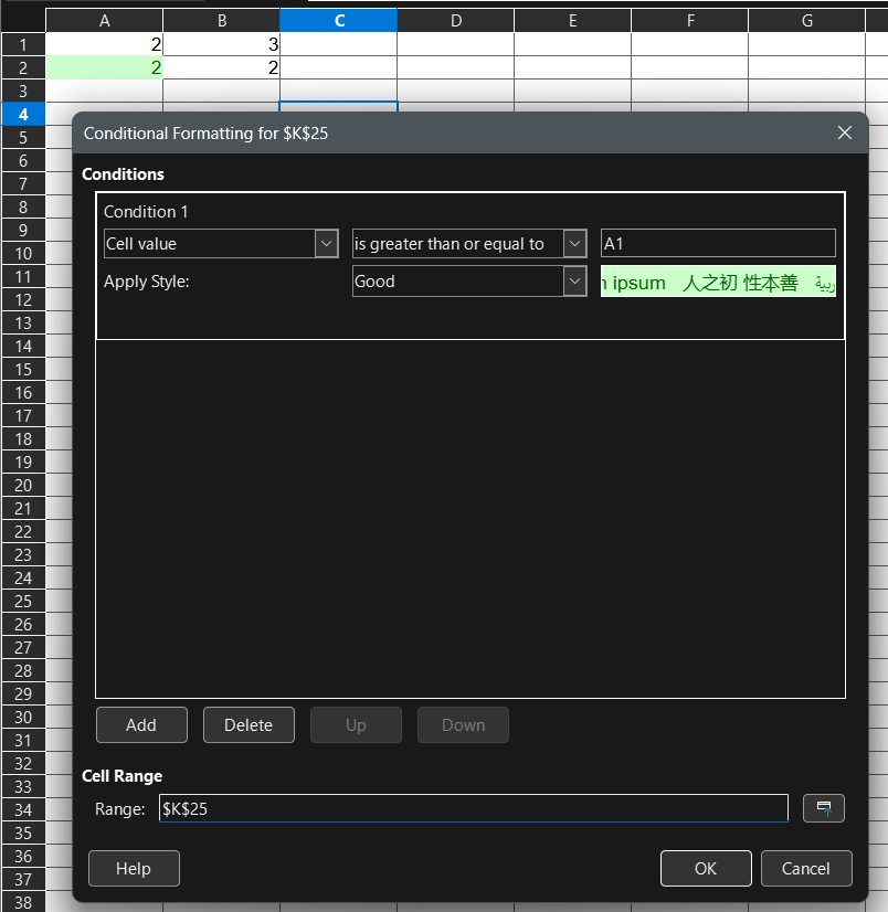

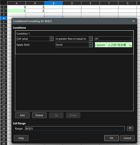

in the previous screenshot the range shows $k$25, don’t know how happened,
didn’t change anything, just redone it now
No. You wrote that there are more conditional formatting.

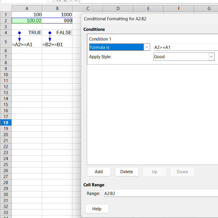

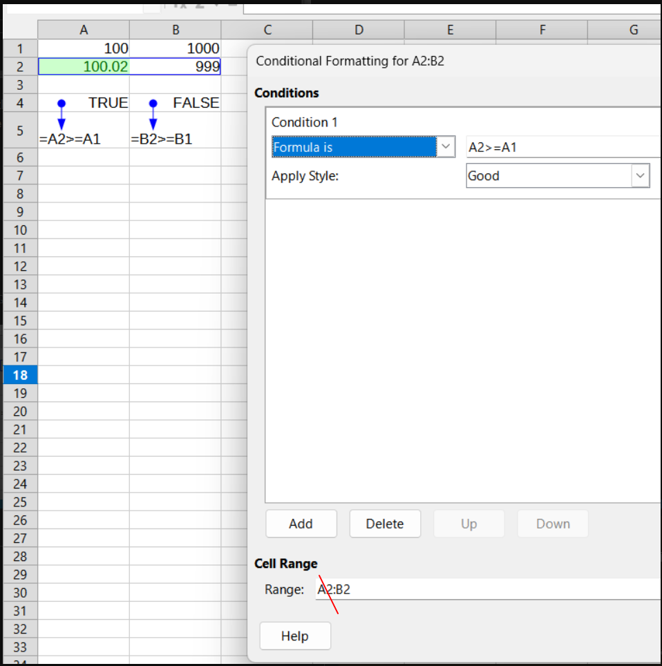

Anyway; you must take the first cell of the cell range (A2) to compare with the reference in the condition (A1), and this relative position will be updated to all cells of the range, unless you add the $ symbol to the condition (i.e., $A1) to make part or all the reference absolute.
As i said that’s a simple file just to show it in the easiest possible way.
ok so you’re saying that IN my latest screenshot above in the cond. form. manager ‘Range: A2:B2’ and 'Condition 1: A1 it means that the cond. form. is applied first to A2 and A1 and after is repeated similarly for the ‘Range’ cells so same way for B2 which will be compared now with B1
