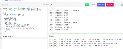

the perl-ish version is already ~20 lines :
438r7fea8 - Perl - OneCompiler

you can follow the link given above, change the input (STDIN),
probably adapt the print statement,
and click image

the script result is close, but it seems to copy repetitive values that are already present - it should only copy unique values. And it only runs successfully with the given data, but if using different data it returns “Program did not output anything!”.

it was only printing matching lines.
I’ve updated the script to (hopefully) help clarifying : v2 - Perl - OneCompiler
