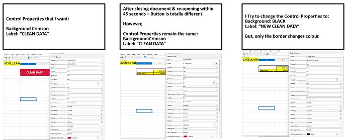

I’ve been a long-time user of Libre Office. I’m now having a problem that is very frustrating. I don’t know if it is something I’ve done (eg altered a setting) or there’s a deeper problem.
I created a Macro with a “Push Button” Control as I’ve done many times before.
I went into “Control Properties” and entered a Label Name, changed the Background Colour & Font.
The Macro works perfectly.
However, when I closed the document & re-opened, the Control Push Button had totally changed in appearance. The Background colour had disappeared and, instead & the Label Name was gone.
I went back to “Control Properties” to change the Button Colour. But, when I try to change the button colour the button doesn’t change, only the border around the button changes colour.
I deleted the button & tried again.
Same thing happened again when I closed the document & re-opened.
For some reason the Push Button format changes completely.
But the Button continues to function perfectly.
It’s quite bizarre.
Has anyone else had a problem? I’ve used Macros with Push Buttons on Libre Calc for the past 10 yrs. Documents from the past there is no issue with the Push Button. It is only creating NEW Push Buttons that causes this issue.

I’ve uploaded screenshots with some explanations.
What I also just noticed is that the Macro is irrelevant to the issue.
I did not assign a Macro for this Button, but the same issues occurred.

Your Button have an imported background image. It is present in the zip archive. The imported image shows a screenshot of some spreadsheet/sheet.
What is that?
Maybe some macro will add the image to the botton? Please upload the related macro codes here.

There are three Control objects in your attached file.
  • Switch Form control elements to Design mode and
  • use the navigator
  • with Zoom=400 value:
    you will found the another two objects.
I just deleted the format properties, I have unhide the hided row 8, and I have set the column/row sizes to the default values in your sample file:
PROBLEM SHEET_Zizi64.ods (260.3 KB)
You must know how they was inserted and how they was size-reduced in your file.
