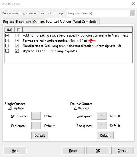

I’m using a nearly 400 page document in canadian english and have a tremendous amount of numbers that were formatted as cardinal with letters and need to be converted to proper ordinals:
image description

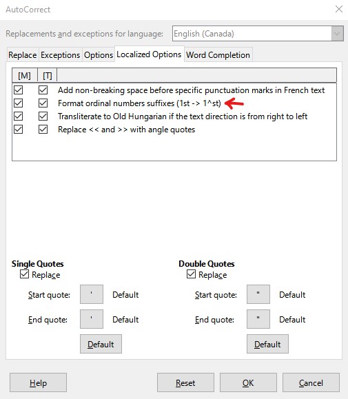

I’ve tried using the document wide auto correct:
but unfortunately it doesn’t do anything. It corrects “everything else” such as double spaces and so on but doesn’t correct a single ordinal. Does anyone know how to correct the entire document’s ordinal numbers to the proper supescript suffix without me having to go through every page and fix it manually?

To apply AutoCorrect options to all text after modification of the settings, use Format>AutoCorrect>Apply
I’m presently on an outdated version of LO. I’ll check later that this menu command is still valid.
the option is now under [tools - auto correct - apply] and does a lot of things, stealing spaces and linefeeds and so on, but not ‘upping’ the ‘st’ suffixes … bug? or depends on fonts or settings about language or other?
i’d never use this option, so i’m not familiar how it should be, on my system - winx64, OS german :-(, LO set to english interface with german locale, - it’s like that in 3.5.1.2, 6.1.6.3, 7.1.0.0.a0+
just played a little with language settings, user interface: english (UK), locale setting: english (UK), default language: english (UK) and enhanced language support: ‘ignore system input language’ made it for me, ‘upping’ works on typing and on apply … didn’t counter check which option is neccessary and which not, just try yourself …
@newbie-02: I just checked with 6.4.6.2 and Tools>AutoCorrect>Apply does not work like it did in older versions, at least for ordinals. I tried playing with language attribute to no avail. It works as expected while typing but not later. A regression?

Thanks all for your help, a friend of mine provided a functional solution to such a bizarre problem. I guess the devs overlooked this bug when doing everything else.
Unfortunately the site won’t let me upload any more screenshots for some reason so I’ll have to describe it.
Use find and replace, search for " 1st " regardless of formatting. Then tell it to replace 1st with 1st using format: “superscript automatic.” This will replace all 1st with the superscript equivalent. Do this for all ordinals in the entire document, 1 through to however many you have. Then tell it to search for 1 (without the st) that has the formatting “superscript automatic” and tell it to replace all 1 with 1 using formatting “normal position” that will then replace all the superscript 1s with their regular counterpart, while leaving the superscript “st” after it. Again, repeat for all ordinals in your document.
It’s clunky but it works. Thankfully the automatic type-fix works to correct ordinals while typing so I shouldn’t have to deal with this again.
