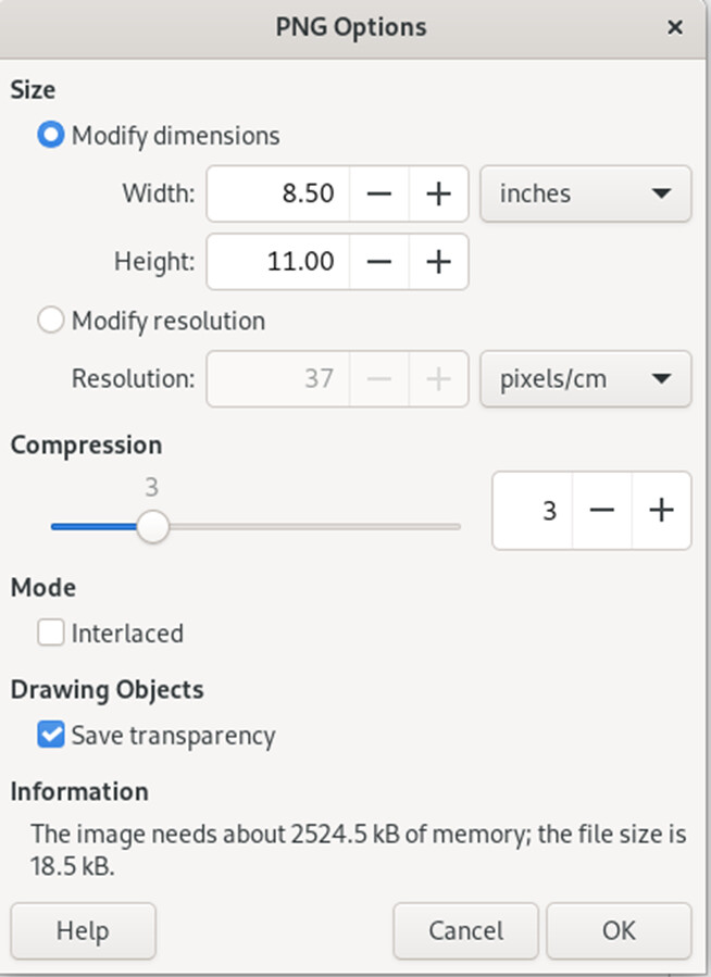

I am using command line to convert emf to png files, but since emf file does not have a background by default, when converting, libreoffice generates a huge white space behind the actual image. Libreoffice does have a save transparency option in the settings
but i dont see any CLI reference for this option at Graphics Export Parameters
The closest one is translucent and ExportOnlyBackground, but toggling these two parameters to true or false didn’t make any difference.
My cmd:
soffice --headless --convert-to ‘png:writer_png_Export:{“ExportOnlyBackground”: {“type”: “boolean”, “value”: “true”}, “Translucent”: {“type”: “boolean”, “value”: “true”}}’ i1.emf
any idea where went wrong?
