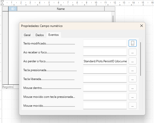

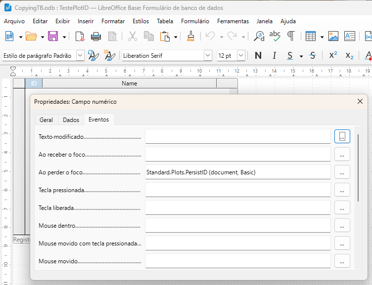

Event is ID - On losing focus
But I think better is Mouse button released (to click inside control).

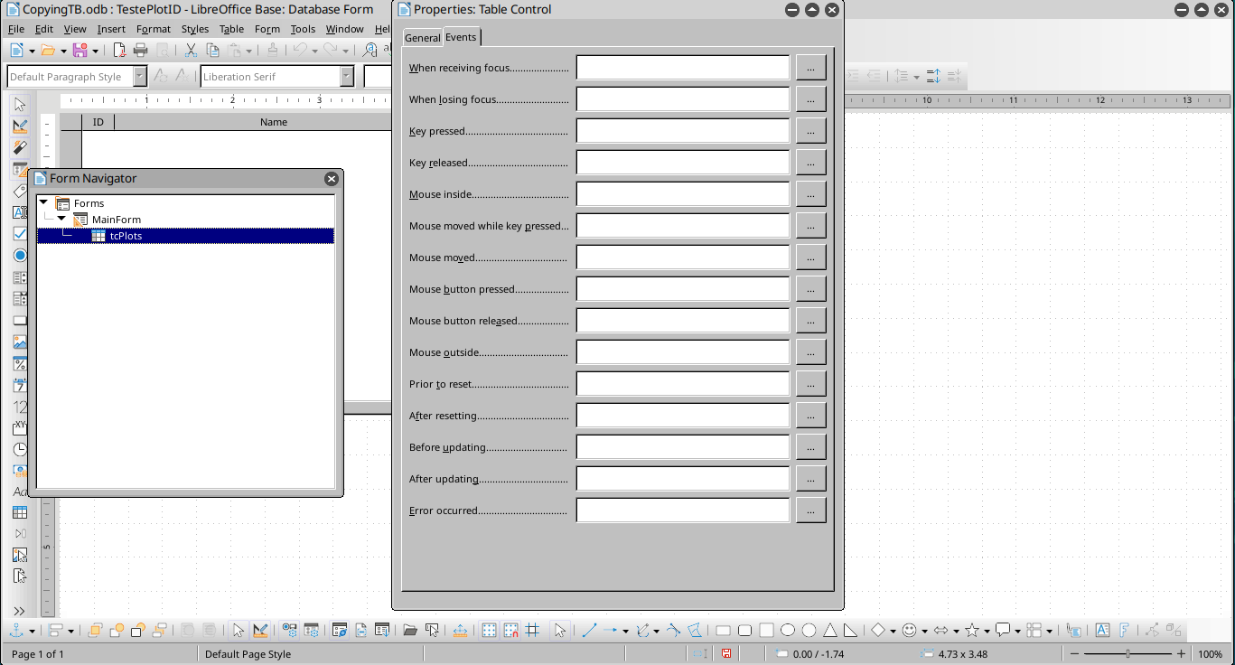

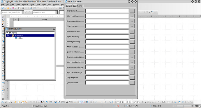

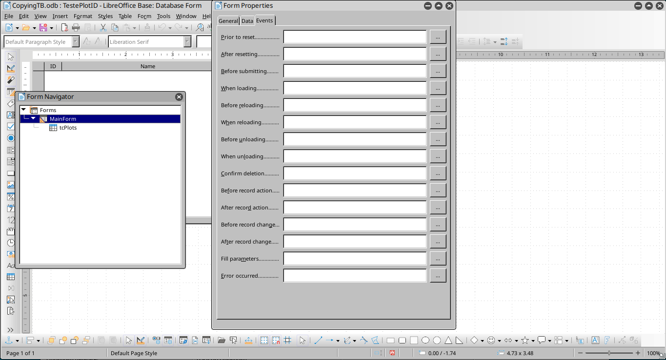

when I try to open tables of forms. Looking at CopyingTB.odb where/when is the macro engaged? I looked in the events of the control and form and did not see anything.

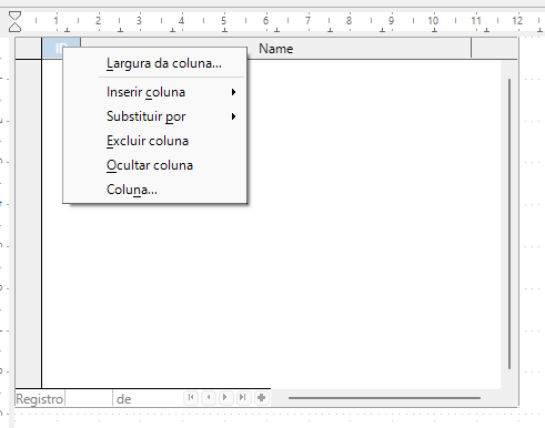

TableControl > ID > Column > Events (of the column).

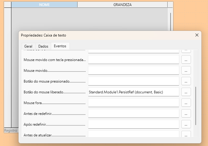

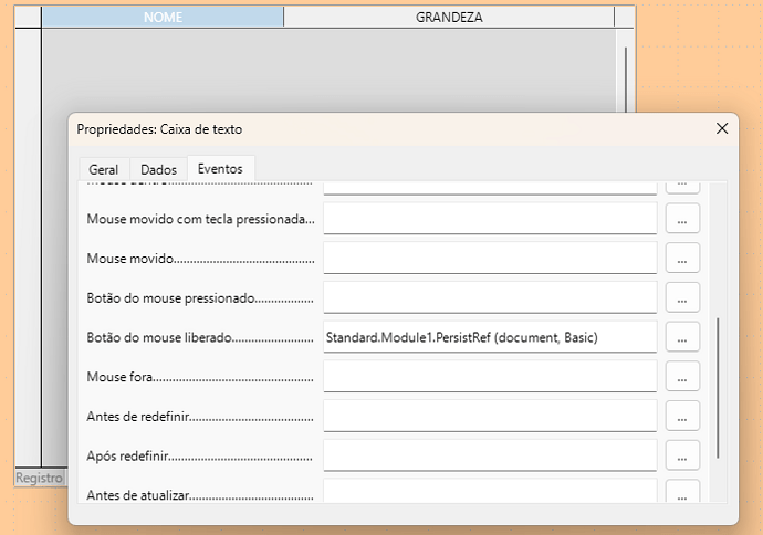

But please open and check these 2 new dummy DBs I sent, in another machine with another LO’s install. I included routine for your layout without the plot_id control, and Event After update.
ID_Event
Enclosed example persists id both on
  • clicking NOME
    or
  • After updating GRANDEZA
Without id showing up in the TableControl.

Also, when I look at CopyingTB.odb I do not see the macro selected in the events of the form or the control.
