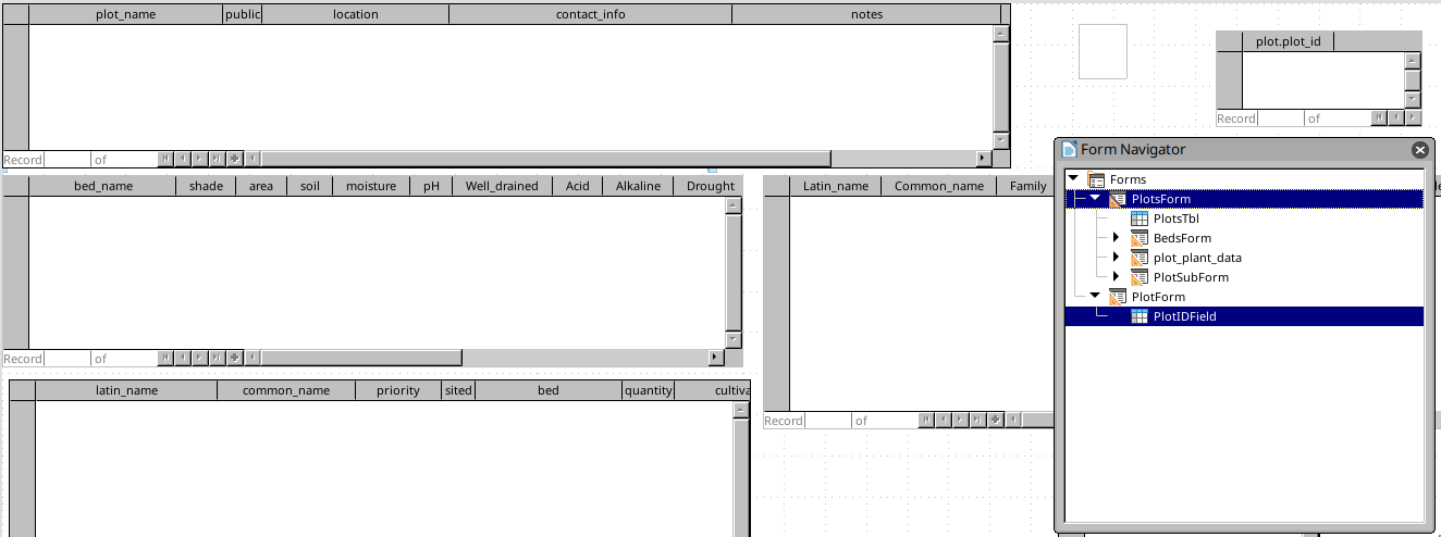

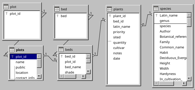

Hi all,
2Tables: PlotsForm (connected to ‘plots’ table) and PlotForm (‘plot’ table)
2Controls: PlotsTbl (PlotsForm) and PlotIDField (PlotForm)
‘plots’ table holds info + plot_id (pk) for each plot.
When I change records in the PlotsTbl control I want the value in the plots.plant_id column column to be copied to the first record of the only column in the table plot.plot_id.
Every-time I choose a new plot from the PlotsTbl control the first and only record in the PlotIDField should be changed so that queries can reference it and be able to see which is the currently selected plot_id and when I go to create a report it will create it based on the value in plot.plot_id.

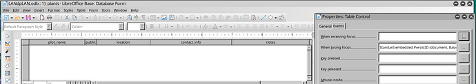

:ok: did an exercise here; but as I don’t have your form layout, it’s speculative…
[plot_id] persisted in table’s PLOT only (pk) ID field.
Say you have a TableControl for PLOTS.
Select the row. If update msg does not show up, insert cursor in the [plant_id] control and leave it (TAB or Enter).
Event = When losing focus
Sub PersistID(Evt As Object)

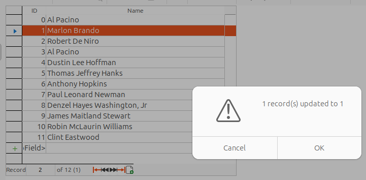

Here the DB modified for this thread.
Select a record and value in the id column is persisted in PLOT’s only field.
Rem: if msg does not show up, place cursor into field ID and leave it – TAB or Enter.
CopyingTB.odb (15.1 KB)

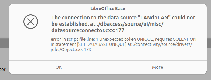

When I try to open CTBTT.odb and CopyingTB.odb I get these errors:
The connection to the data source “CTBTT” could not be established.
SQL Status: HY000
The connection to the external data source could not be established. No SDBC driver was found for the URL ‘sdbc:embedded:firebird’. at ./connectivity/source/commontools/dbexception.cxx:413
A connection for the following URL was requested “sdbc:embedded:firebird”.

I did:
sudo apt-get install libreoffice-sdbc-hsqldb
and it worked allowing me to open the tables once, but only once. After closing and reopening now I’m getting
The connection could not be established. The database was created by a newer version of LibreOffice. at ./connectivity/source/commontools/dbexception.cxx:41
and once again I can’t open the tables or the form but I was able to copy the macro

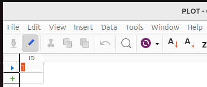

CopyingTB.odb is doing what I want by copying the id to the correct place. Thank you!

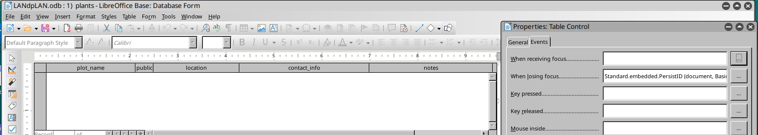

I’d like to understand it better so that I can modify it and use it for my application. Some questions to help me understand:
When/how is it called to run? I was expecting to see it listed in the events tab tied to something like ‘when record change’.
I’ve added a table to the example that shows the plot_id on the plot table. I have to select the table and click refresh to see the change. Is there a way to automate this?
