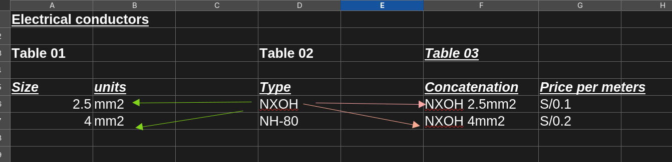

I wish to create a new table using 2 tables like this:
Table 01:
Cable SIZE / UNITS
2.5 /MM2
4 /MM²Table 02:
Cable Type
NXOH
NH-80then i wish cross like this table 03:
Cable / Price per meter
NXOH 2.5mm2 / S/0.1
is this possible?
Table 01:
Cable SIZE / UNITS
2.5 /MM2
4 /MM²Table 02:
Cable Type
NXOH
NXOH 2.5mm2 / S/0.1
is this possible?
Are there any relations between the 2 tables? Or do you want row 1 from Table 01 connected with row 1 from Table 02?
Table 01 and 02 without relation, I wish something like a permutation (combine all elements of the columns using concatenate)
… Then I wish to concatenate columns from table 01 and 02, and when I have a table 03 then relate with another table 04 with prices.
But I wish that dynamically the table 03 and 04 change when I add more rows in tables 01 and 02

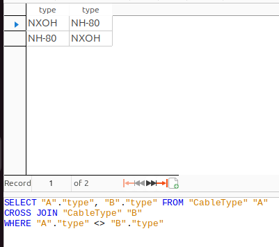

Yes, but you have ti write it yourself, as your S/0.1 is not part of your tables. (You could try a hallucinating AI…)
For this your topic/title is quite good:
Google for SQL CROSS JOIN
Joining 2 row sets with HSQL: Apache OpenOffice Community Forum - [SQL] JOINing 2 row sets - (View topic)
Something along this line?

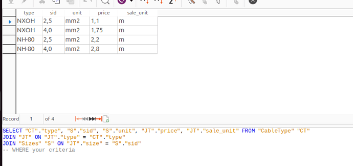

But if say
NXOH combine itself with NH-80 as apparently it is your intention, how to know the price?
If NOT, if each type goes by itself, it will be a common many-to-many relationship.
